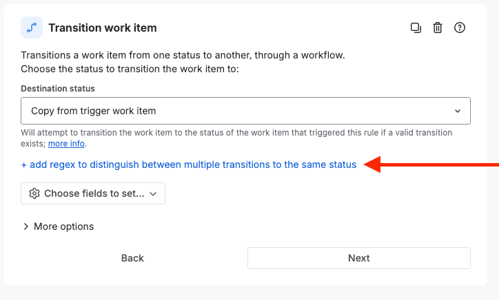

The problem with a single "Done" or "Closed" status, is that Automation rules dont work when there are multiple transitions that can take you to your "Done" or "Closed" status. Automation rules will:
* Pick an arbitrary transition as long as it goes from current status to the target status
* Ignore any restrictions on the transition
For instance, we have a transition called "Won't Do" that goes from any status to "Done". Currently this transition will bring up a "Won't Do" screen to take a comment so we can require one, and it automatically sets the Resolution to "Won't Do".
The issue is we have is regarding an automation we use. We have a status called "Work Completed", and we want to transition these issues to "Done" when they get deployed. We have an automation rule to do it, but because automation rules only can pick a destination Status, not a transaction, the automation rule can pick the "Won't Do" transition, which requires a screen and a comment. This makes the automation rule fail.

In the Transition Work Item action there is an options for selecting the specific transition you want to use.
