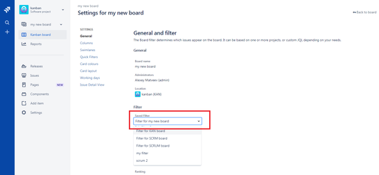

You can create a filter, which queries issues from several projects. Then go to the Kanban board settings and set the filter on the General tab.

I have a multi-project Kanban board with swim lanes configured for each project. Setup is as Alexey explains with a filter that typically starts with "project in (XXX, YYY, ZZZ)" to pull in projects XXX, YYY, and ZZZ.
It seems that the project you start with becomes the 'owner' of the multi-project Kanban board which does affect navigation between different boards. Board Settings are configured from the '...' UI option on the board.
