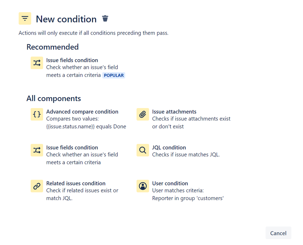

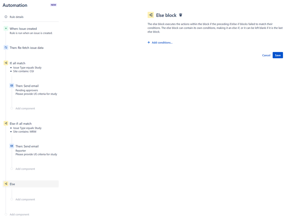

I'm not seeing If/Else in here. Is that something I have to configure for it to show up here? Or am I looking in the wrong place?
Bill Sheboy
December 2, 2021
Matt, would you please show an image of your complete rule?
I believe the image you posted for condition test options only appears when inside of a branch, and so if/else is not permitted at that nesting depth.
Outside of a branch you should see all of the options for conditions.
Thanks!

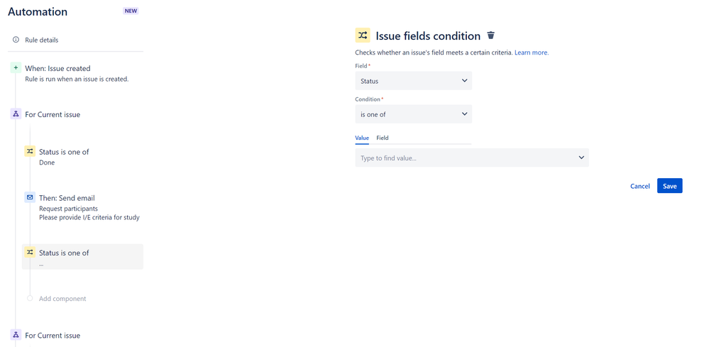

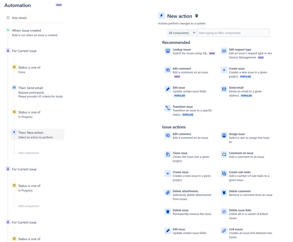

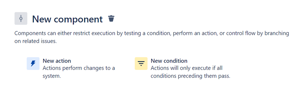

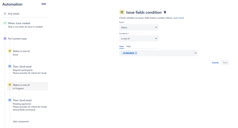

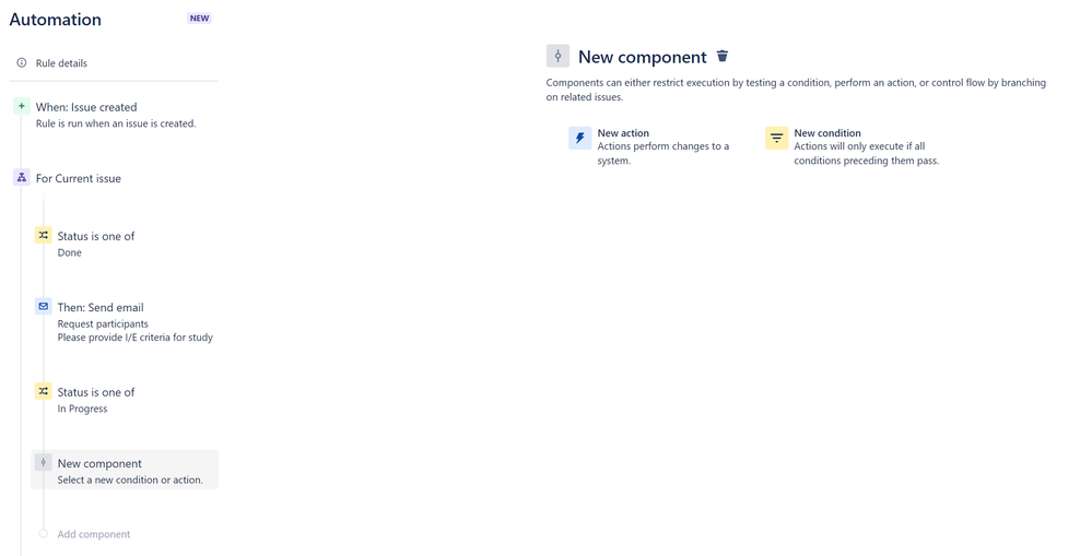

Matt Crist
December 2, 2021
Hi Bill,
This may be overkill, but I wanted to make sure you can see what you;re looking for, so I included several screenshots for your reference here...
Thanks!
1)
2)
3)
4)
5)
Bill Sheboy
December 2, 2021
Thanks!  Yup, that is what I expected was causing this.
In general, you only need the branch For Current Issue if you are using a single condition test *and* want processing to continue after some processing.
For your rule to do what John suggested and following your example, please try this:
  • trigger: issue created
  • action: Re-fetch (to handle the possibility of timing errors not having the data ready to test after the created trigger)
  • if/else condition...issue condition: status is Done
    • action: do something A
  • else-if condition: status is In progress
    • action: do something B
  • ...repeat as needed
  • else
    • action: do something Z
Like John Funk likes this

Thank you! So, am I on the right track now?
Like # people like this
John Funk
December 2, 2021
Yep, that’s the right path
Like Bill Sheboy likes this
