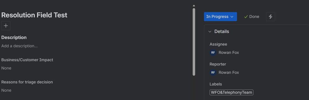

On a new Jira board created for my team whenever an item's status is changed from To Do to any other, such as In Progress, the issue appears to be considered resolved, as the 'Done' resolution field appears next to the status. The issue is also marked with strikethrough formatting on the board, which is visually confusing.Jira 1.jpgJira 2.jpg

Thank you, I have limited permissions to check the workflow, but I'm getting in touch with the space owner to check the above.
As far as automation goes, the only automation is 'When an issue is transitioned to In progress → set Start Date field to current date', which appears to only be doing what it says on the tin and altering the start date, unless that somehow also affects the resolution field.
Rowan.Fox
January 13, 2026
To note as well, with my limited access to Workflows, I can still see 'There are no transitions out of this status' listed under every available status. Would that indicate that there are no actions being performed for transition from To Do?

Could you also check the history of the issue. It might be that it has been moved to a status that sets the resolution i.e. 'Done' and then been moved back to in progress. This is actually more likely the problem.
If that is the case ask your admin to set a Post action removing the resolution when transition to 'In progress'
