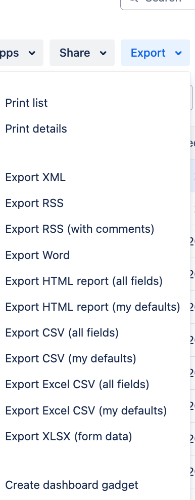

Please find details :
Data copy :
This kind of copying your project and its structure from one instance to another.
This would be the entire project workflows screens field issue etc.
Export Issue:
- This is to take a backup of your entire instance and importing back to another instance or at time of data loss
- Export issues can be also used to export only issues based on JQL or filter
Thank You,
Prachi
