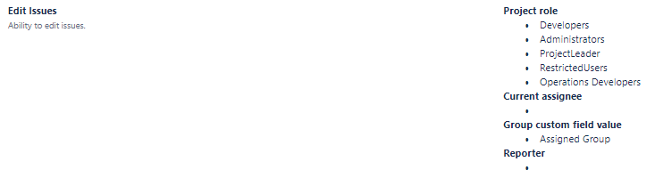

I can confirm that the current assignee has permissions for both Move and Edit issues:
And the workflow does not have any properties set in this status. Additionally, assigning the user to the Developers role did not help to move the issue, but assigning to "ProjectLeader" helped to make him move the issue.

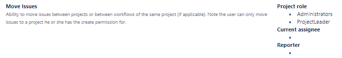

I have assigned the "ProjectLeader", "Administrators", "Current Assignee", "Reporter" the permission to Move issues in a project. All 4 settings are currently applied, but it seems that the users are only able if they are assigned the "ProjectLeader" role. Having them assigned to an issue does not allow them to move this issue.
Is this something that is expected?
No restrictions on the workflow are applied.

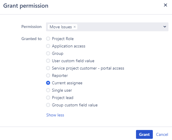

now I think there is a misunderstanding: The setting is made correct and also in the UI there are no options for specifying any groups of users who can be assignee. See here for the setting made: image.png
I cannot update to a later version, but version 9.4.1 is our current one and there might have been changes - that is for sure.
But from a technical perspective, if the setting has been made as per the above dialog, I would expect the assignees to be able to move the issue.
