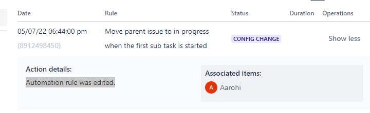

Hi Team,
PFA automation rule.it audit log it is now showing the status expect "Configuration change"
Please help
Thanks,
Anil

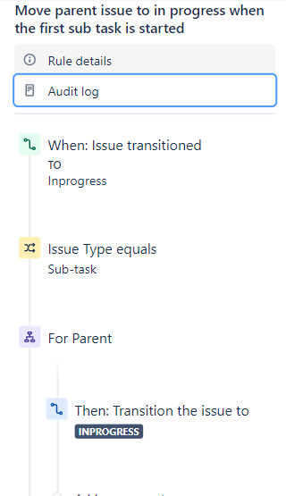

Walter Buggenhout
July 5, 2022
Hi @Arnav,
Your conditions are in the wrong place in the rule. The should come before the For Parent branch. So:
  • When issue transitioned to In Progress
  • If issue type = sub-task
  • For parent ...
  • Transition issue to In Progress
(your initial trigger already implies that the sub-task you start from is in progress, so no additional validation of statuses would be needed)
 Hope this helps!
Arnav
July 5, 2022
Hi Walter,
I have followed your steps and below is the result.
