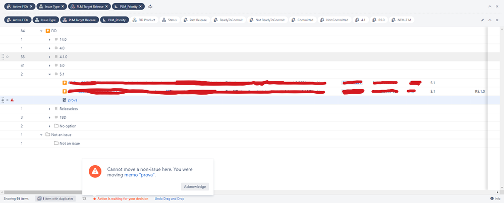

Hello Alessandro,
thanks for your answer, but unfortunately your suggestion doesn't solve my problem. I modified the configuration as you proposed and I tried again, but the result doesn't change.
In order to clarify my problem, I'm attaching a screenshot (sorry had to blur some sensitive information) which hopefully can help better understanding the situation
Please let me know if this is now more clear and if you have any further suggestion on how to address the issue.
Thanks in advance
Marco
Hi, @Marco Bertolini. Unfortunately, I don't think this screenshot will clear things up. We'd need to see the automation rules (Generators) being used to create the structure. Also, we'd have to take a closer look at the Transformations you are using, too. (BTW, that's an impressive collection of Transformations.)
Somewhere in that mix, there's a higher-priority rule that's conflicting with your desired "manual adjustment."
