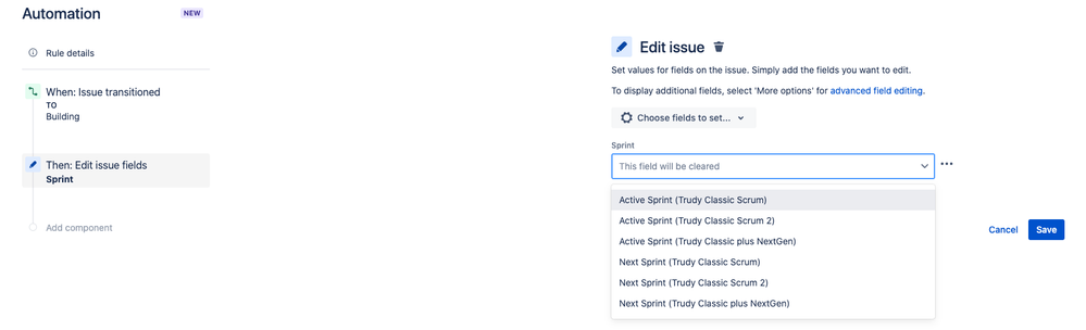

If you are okay with clearing the Sprint field of all data you could use a rule like this:
You would need one Edit action to clear the Sprint field, and then a second Edit action to reset the sprint field to the test sprint.

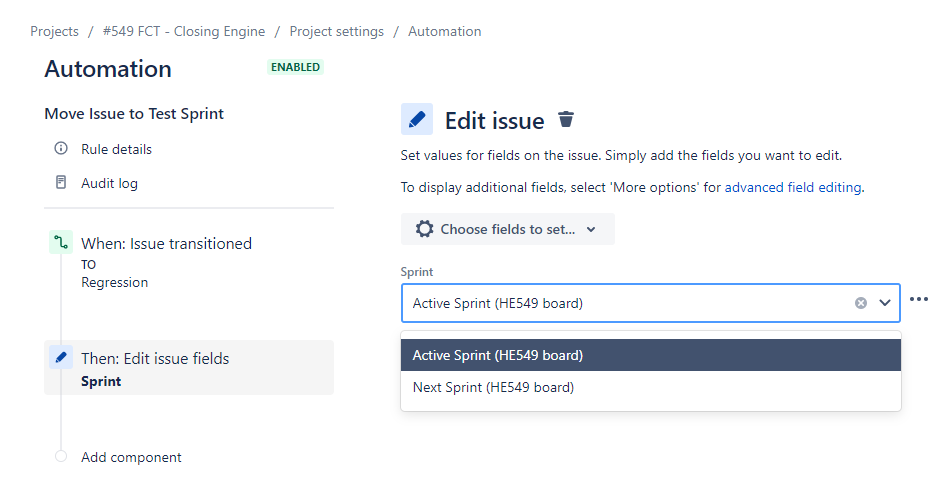

I just tried this but I cannot choose the specific sprint that I want the issue moved into. It only gives me two options...Active Sprint or Next Sprint. I have 2 active sprints (Development and Testing) and want to move the issue to the second one. When I choose Next Sprint, it creates a new sprint and moves the issue to the new sprint. If I select Active Sprint, it keeps it in the current sprint. Is there any Automation action that will let me choose a specific sprint?

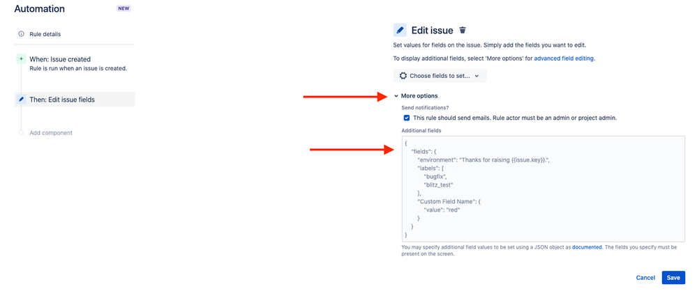

Instead of selecting the Sprint field from the pull-down, you could used the More Options of the Edit Issue action to explicitly set the Sprint field to a named sprint.
This post shows the code for setting the Sprint field.
https://community.atlassian.com/t5/Marketplace-Apps-Integrations/Set-sprint-ID-using-advanced-JIRA-Automation/qaq-p/1271533
