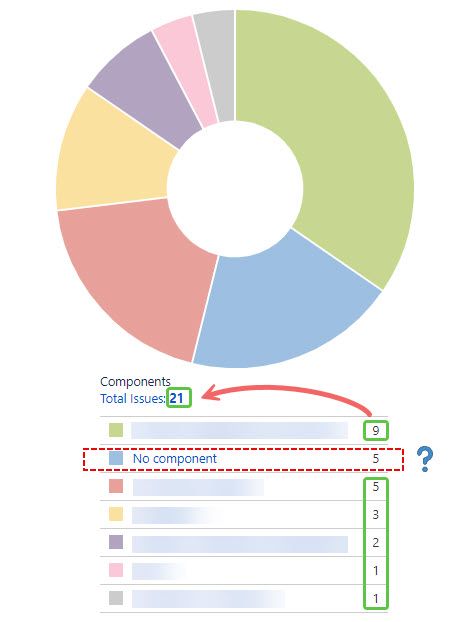

We have a strange issue appearing when we attempt to report, via a pie chart, on one of our JIRA projects. Steps to re-produce this issue:
1 - On the project I go to Reports > Pie Chart Reports
2 - Leave the "Project or Saved Filter" as is and change the Statistic Type to "Components"
3 - Run the report
4 - I see there is a large part of the chart called "No Component"

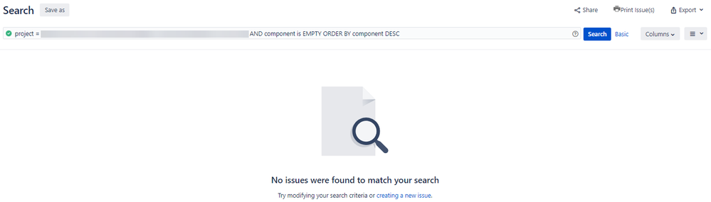

5 - If you click through on this piece, however, I'm brought to a search view that gives no results (JQL: project = projectName AND component is EMPTY)
Any ideas on what may be causing this issue? We've attempted to view the component data in several ways, and nothing seems obvious when it comes to the incorrect count.

Chris, did you ever got a response to this? I'm facing a very similar behaviour in my JIRA instance.
The "No component" piece of the pie, with a number of items supposedly found in that category on the chart, show "No issues were found to match your search" when accessing the results (clicking on the "No component" entry); and it searches for a "Component is Empty" when there are no records in that condition. The rest of the "pieces of the pie" and the "Total Issues" add up perfectly.

Ok, can you run these JQL queries and tell us the numbers each one returns?  (Yes, I know, you've run the first one already, but I'd like to see what it does when you run it from the issue navigator, rather than the pie chart)
  • project = projectName AND component is EMPTY
  • project = projectName AND component is not EMPTY
  • project = projectName AND component = "No Component"
Christopher Taylor
October 21, 2020
Hi Nic,
No problem, thank you for the help so far.
project = projectName AND component is EMPTY - 1 result (this was a new issue created yesterday which hasn't been classified yet)
project = projectName AND component is not EMPTY - 1984 results
project = projectName AND component = "No Component" - I get an error when running this... "The value 'No Component' does not exist for the field 'component'."
Thanks,
Chris
