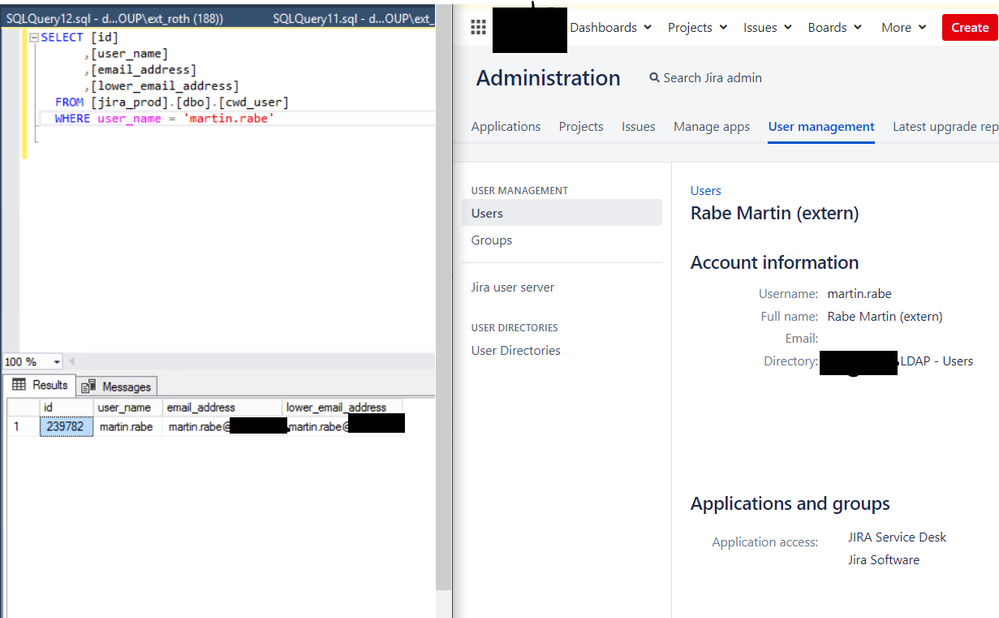

see my screenshot here - this is the same user. It does not make sense to me, but in the DB the mail is available and 'in Jira' it isn't.
A restart didn't solve that and in the LDAP the user's mail address is even there. Also the user does only exist in the LDAP.
When I try to run the Cloud Migration Assistant this user leads to an error and we have no idea why... Is it more clear now? Before I saw that I even thought this is not possible -  but it is.
