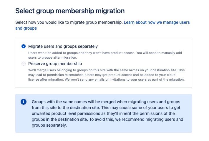

However, when using the Cloud Migration tool, I'm not seeing an option for "Only users and groups related to the selected projects", these are the options I see:

Hi @Doug Reid
I just saw the option I provided are for the new version to be installed in Server/DC.
But the option you have represents the same.
Doug Reid August 31, 2023
Thanks Marc, I'll give it a try!
