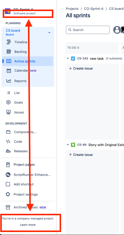

What type of project are you using get that information from the areas I've highlighted in the image below.
