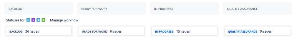

Here are some of the columns in the Kanban config screen:
Here are the column headers from the live board:
Clearly *something* is filtering the issues from the Kanban board. The template I'm using has fairly limited options for configuring the Kanban board and so I can't find anything in the options that could potentially restrict these issues from showing up.

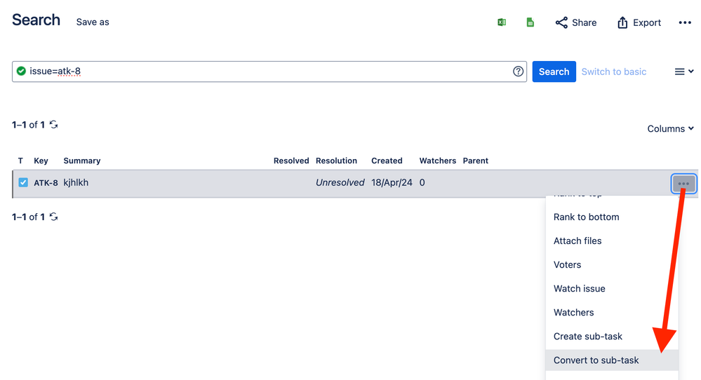

I'm not seeing the Convert to Sub-task option directly in the issue details view Action menu, but I do see it in the Action menu available from the View All Issues screen.
