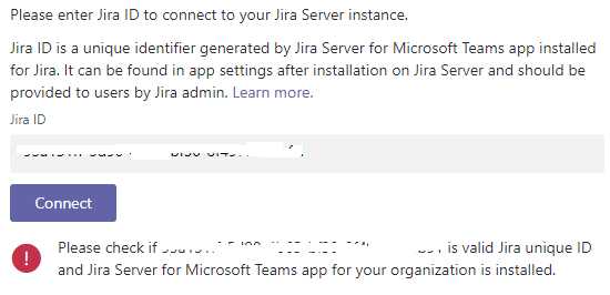

I have installed 'Microsoft Teams for Jira' app in my Jira instance and configured the Application link as per the documentation. Also, installed the Jira Server App on my teams.
When I try to connect for the first time for using the BOT from Teams, I am able to successfully authorize and use the bot.
But with the same JIRA ID my team members are not able to authorize, they get the following error, screenshot FYR,
After they try it gets auto logged out for me as well and I get the same error.
Any inputs much appreciated.
Thanks.

Hi @devsuresh2005 Check the Microsoft Teams for JIRA plugin Configuration to get correct JIRA unique Id. Install JIRA server in JIRA Server connector in MS Teams.
Then type Connect >> Press enter >> Enter JIRA ID.
As per the screenshot, it seem that you are entering worng JIRA id , might space in unique ID.
Hi Vikrant, thank you for your inputs but the same JIRA ID works for the first time but not working for others and for me too from the second time. Thanks.

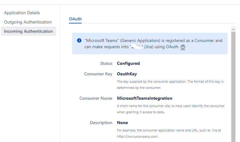

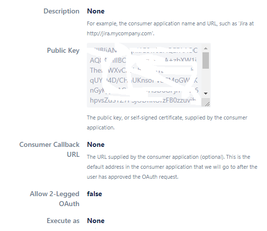

Hi @devsuresh2005 H.mm... it weird but possible to fix. I think some steps are missing. Have you tried to create application link again .Check correct public key is added in Application Link, oathkey and Consumer Name is correct.

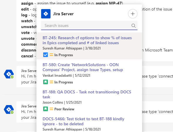

Here is the screenshot, it works well for the first time.
And here are my incoming authentication configurations,
And I have not configured any outgoing authentications FYI.
