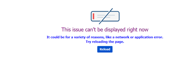

Hi all
I have Installed "Herzum Amplifier for Mattermost" to have  communication between jira and mattermost.
When  i disable "Mattermost JIRA Issue Panel" module of this app there is not any ERROR
but also there is not any UI element on  issue page to send messages to Matttermost channels.
If i enable that module messaging features are available and cool BUT every click on any of Transition buttons cause an awful error
then I should reload page and all things is right after reload
In log file i found a error message that is too short and ambiguous
2020-04-13 13:43:57,832 http-nio-80-exec-14 ERROR jiraadmin 823x44670x1 2tip6o 172.XX.XX.XXX /secure/WorkflowUIDispatcher.jspa [c.h.p.mattermost.client.MattermostClient] :::::ATTACHMENTS HERE::::
2020-04-13 13:43:57,832 http-nio-80-exec-14 ERROR jiraadmin 823x44670x1 2tip6o 172.XX.XX.XXX /secure/WorkflowUIDispatcher.jspa [c.h.p.mattermost.client.MattermostClient] {"attachments": [

Kaveh M Mehr
April 14, 2020
Dear @Ruslan Shlain
I Found that this error  disappears when i disable another app witch is an RTL UI app
I can not send that app to you now
I will negotiate to RTL UI app provider and send you root cause error as soon as possible
Regards
KMM
Ruslan Shlain
April 15, 2020
Please keep us updated. Let us know how can we support you to make Amplifier for Jira successful in your organization.
Kaveh M Mehr
May 18, 2020
Dear Ruslan_Shlain
I find the source of problem
your app derive page direction (rtl/ltr) from jira default langue so some problems occur.
If i can set the direction of you app in a config or properties file all problems will be resolved.
Is there any way to set the direction of your app?
Thanks
KMM
