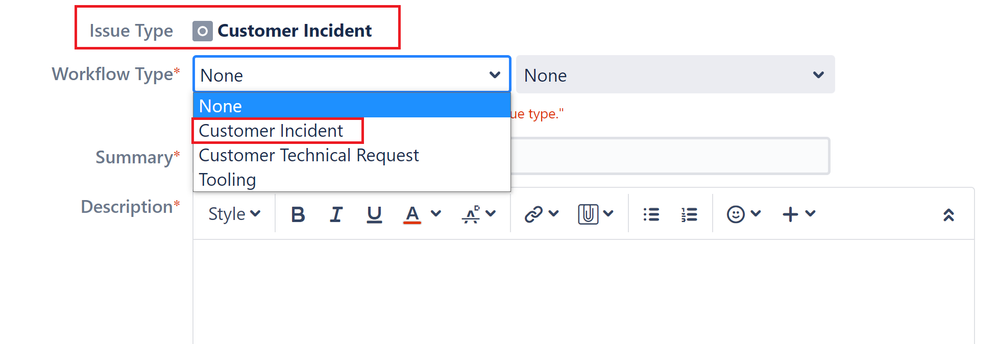

I have a requirement to match the issue type with the first option in the cascading dropdown list when creating a new ticket.
For example,
1. If the issue type selected is "Customer Incident" the first drop-down option in the    Workflow Type should automatically display "Customer Incident".
2. If the issue type selected is "Customer Technical Request" the first drop-down option in the Workflow Type should automatically display "Customer Technical Request".

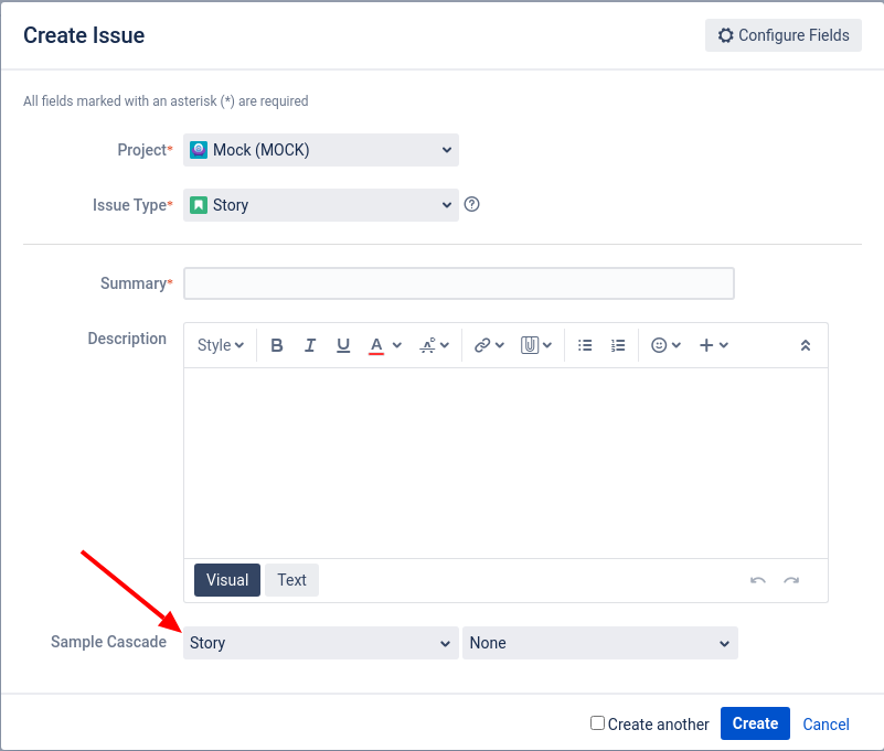

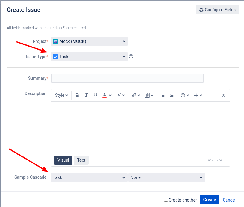

Below is a screenshot of the Behaviour configuration:-
Below are a couple of test screenshots for your reference:-
1) For Story issue type
1) For Task issue type

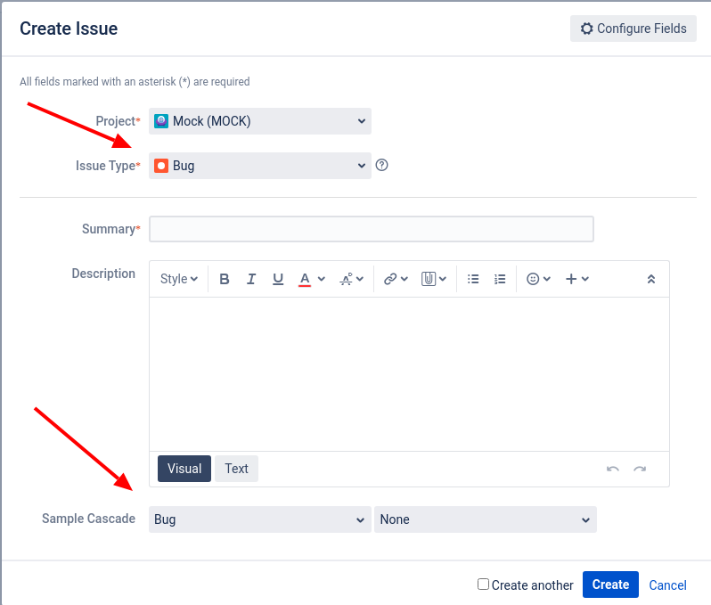

3) For Bug issue type

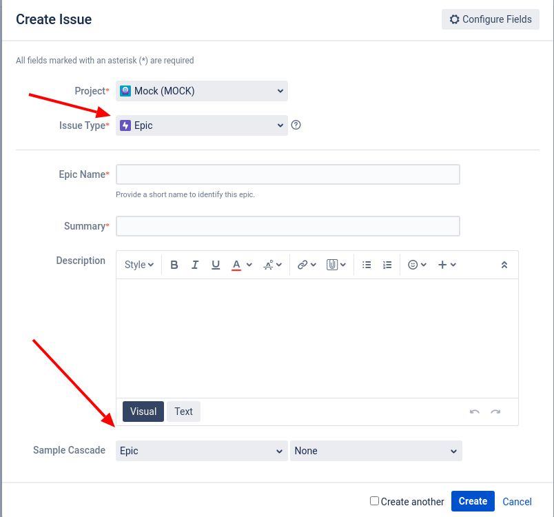

4) For Epic issue type
If you observe all 4 screenshots above, you will notice that the parent option in the cascading field changes when the issue type changes.
I hope this helps to solve your question. :-)

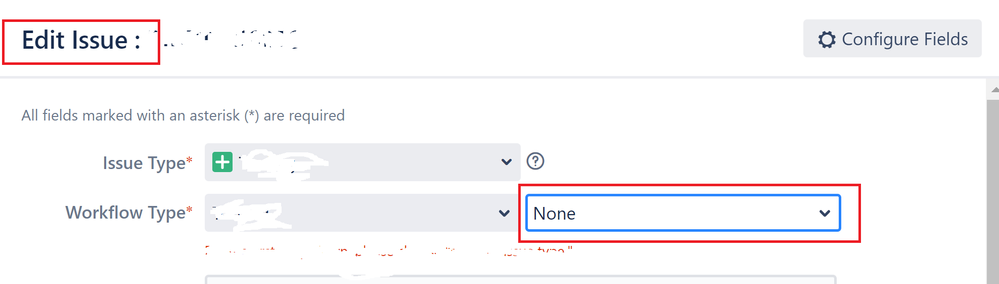

Hi @Ram Kumar Aravindakshan _Adaptavist_ ,
I came across an issue while trying to edit a ticket. The second drop-down option in the cascading field row appears as "None."
For ex: Whenever I try to edit the ticket, the second drop-down menu keeps switching back to "None" instead of staying on the selected option.
Could you please suggest this?
July 19, 2023
Hi @jira_admin_cu
Could you please share your updated code along with a screenshot of your Behaviour configuration so I can get a better understanding of the issue?
Thank you and Kind regards,
Ram

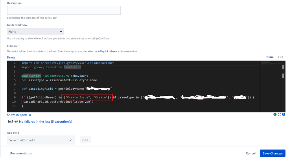

jira_admin_cu
July 19, 2023
I added ["Create Issue", "Create"]) , then its working
