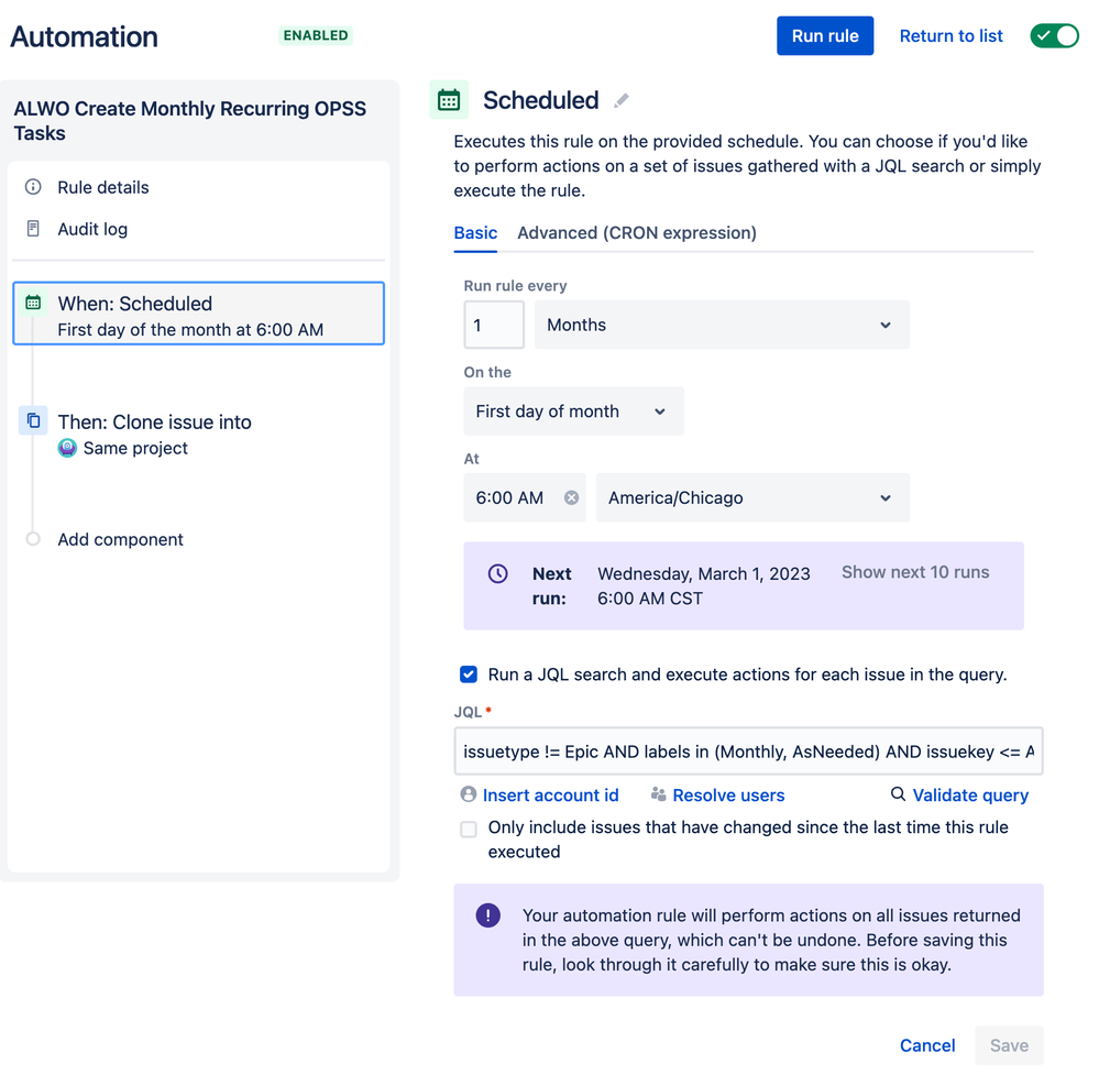

It seems like Atlassian's intent for the Manual trigger for automation rules is more about testing than about actually kicking off a larger process by hand. You're correct that a manually triggered rule will only run on the issue you run it from.
Without knowing more about your use case, it's tough for me to suggest a good option, but you might do well with a scheduled automation that runs on the (for instance) 5th Saturday of every 12th month.
I use this kind of scheduled automation to create recurring issues on a weekly, monthly, or other basis. but a nice feature of this kind of scheduling is that it also gives you the option to run the rule (globally or in a single project) manually from the Automation itself.
It sounds like you could maybe just use the scheduled automation, though, assuming you can use JQL to identify your "purged" Sub-tasks.

If you set up the schedule, you can run it ad hoc from the automation itself (kinda like a bulk manual automation) whenever you want. (Assuming it won't hurt anything if it runs once a year or something as scheduled).
