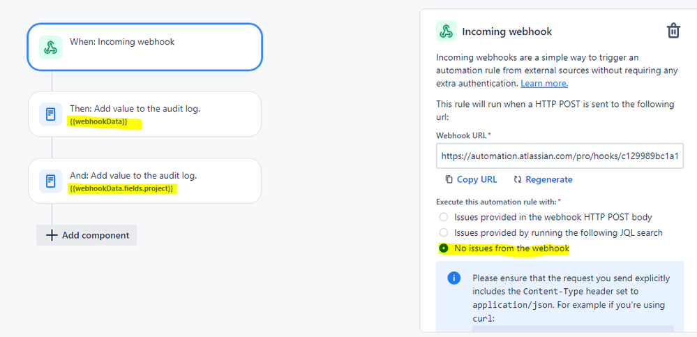

  • Confirm that in your "Incoming Webhook" Jira Trigger set up, you have selected "No issues from the webhook".  (See screenshot.)
  • In your Jira, right after your "Incoming Webhook" trigger, create a new action -> log action -> {{webhookData}} to see what you are receiving from Zendesk.
  • If you want a specific field, you will use the dot notation. so {{webhookData.fields.project.key}} will give you "TEST", this is how you assign your fields in the new task you are creating in your Jira.
