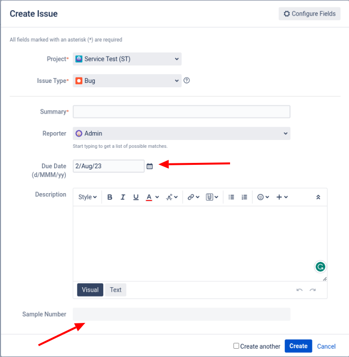

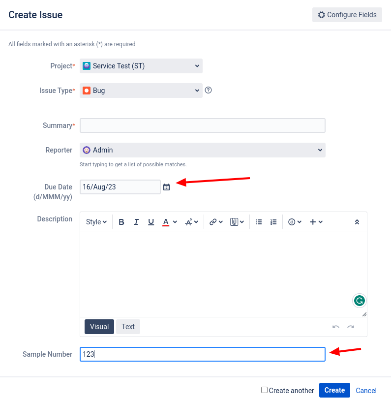

I am also including a couple of test screenshots for your reference:-
1. When the issue is being created, if the value set for the Due Date is before the current date, the Sample Number field will not be editable as shown in the screenshot below:-
2. If the Due Date field is later than the current date, the Sample Number field is editable as shown in the screenshot below:-

Aditya Sastry
August 30, 2023
Thanks Ram and Sorry for the delay but I followed your approach and was able to achieve the ask,
