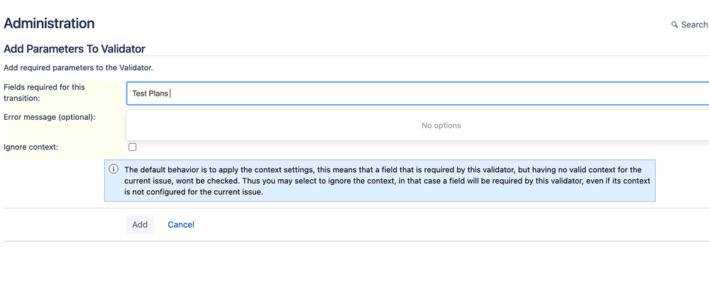

Hello All, I'm using Xray test management, and I'm facing some cases when my team forgets to add test execution to a test plan or even add a test environment to the test execution, so I'm wondering if there is any way to make these fields as mandatory before closing the test execution?

As you mentioned "before closing the test execution" --> does "closing" in this case mean when the test execution is transitioned to a special workflow status (eg. Done, Closed, ...) ?
If so I would suggest to add a validation in the workflow so the issue could only be transitioned to this status when the mentioned fields are filled.

but the issue is that I can't find these 2 fields, "Test Plan" and "Test environment" maybe because it Xray fields even I can't find it in the custom fields list.
Check the attached Screenshots

oh...got you 🙄🙈 could be because xray issues are not native jira.
I‘ll double check this in regards of screens/screen schemes and get back to you soon.

According to xray documentation it is possible to use some of its custom fields though Test Plan & Test Environment are not one of them.
I tried to configure some different screens/screen scheme or work with transition view/screen but wasn´t able to add the xray specific field :/
I can´t ensure 100% but I guess scriptrunner could solve this (in case this plugin is installed in your instance).
