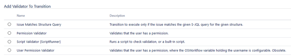

i want that i can only submit the card, when i check one of the boxes.
Those are the Validators i can use, does anyone have the Code that works for my Problem?
I don't have any Plugins.
