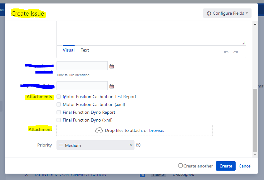

Hi
I am using simple scriptrunner validator to make attachment mandatory on create screen on basis of value of check box. Script is working fine on create screen pop up window but when we use new tab to create issue ex "abc/secure/CreateIssue!default.jspa" , script is not checking attachment while creation.
Here is my script

mogavenasan
January 10, 2021
Hi @kanishka
Looking at both of the screenshots, it looks like the Attachment field is not mandatory. Please clarify this.
Have you also checked the browser Console log to see if there is any Scriptrunner is logging?

mogavenasan
January 10, 2021
Hi @kanishka
What I meant was; you mentioned this:
However, from the screenshots, we are seeing the Attachment field is not required. The required field will have (*) sign at the end of the field name.
kanishka
January 11, 2021
Yes Attachment is require.
(*) is not coming because attachment are not always mandatory. When Checkbox is checked then only it will be required.

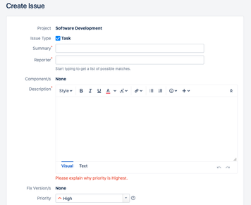

mogavenasan
January 11, 2021
Hi @kanishka
I tested Modify field descriptions on my local machine and it works on the URL; <base URL>/secure/CreateIssue.jspa.
That being said, the testing confirmed that Behaviour works on pop up screens and <base URL>/secure/CreateIssue.jspa URL.
