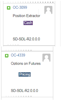

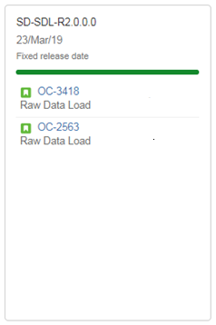

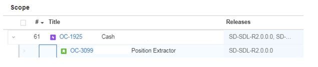

The second picture is from the Kanban Board that shows the card views of sample issues not pulling in, while the third picture shows the Release Report view in Portfolio with the Fix Version that should contain those missing issues.
The first picture shows the Scope view without any filter in Portfolio, which you can see is pulling in one of the sample issues.

Third picture:

Thanks for the screenshots, and that is weird.  From what I can see here issues OC-3099 and OC-4339 should be listed in the Release report for SD_SDL_R2.0.0.0
I tested this out again on matching versions and was not able to reproduce the behavior so there is something erring, or a data configuration causing the disconnect and we will need to take a closer look at the instance to see what is occuring.
