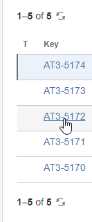

Currently in our Jira instance we have 5 'sub tasks' created which have somehow ended up without an issue type.

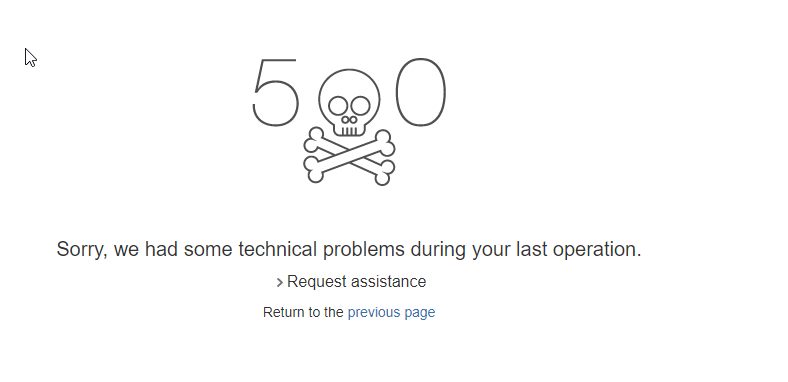

Once we noticed them, we restarted the server and this has caused the lucene health check to fail.

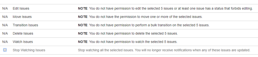

We cannot delete these issues as no one has permission to do anything with them.
Any suggestions on how we could delete these issues?
Thanks in advance2018-05-08 08_46_56-Bulk Operation - NA Software JIRA.png2018-05-08 08_47_09-Oops - an error has occurred.png2018-05-08 08_46_29-Issue Navigator - NA Software JIRA.png

  • Go to the AT project and look at the list of available issue types.
  • Stop Jira and take a backup
  • Go into the database and look through the issuetype table for any parent-level issue type that the project uses.
  • Once you have that ID, you can go to the jiraissue table and change the issue type on each of the five broken issues to it.
  • Restart Jira
  • Re-index the project
  • Run the integrity checker and let it correct anything it finds
  • Now delete the issues if you want rid of them
