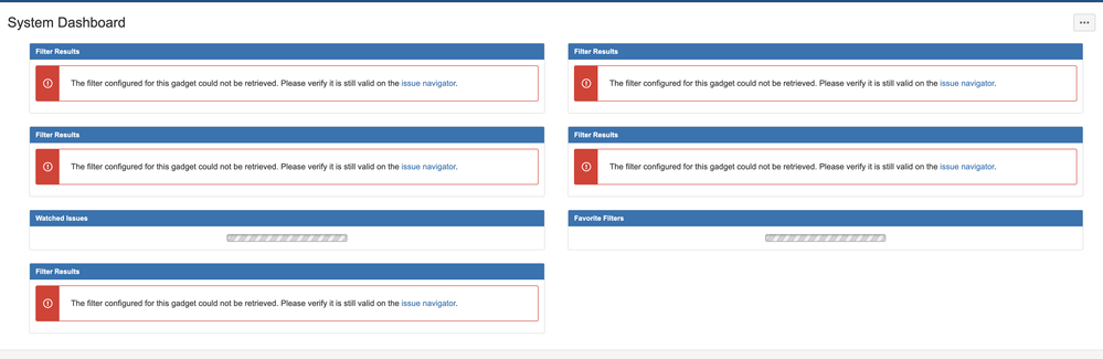

I’m writing about a new problem we started experiencing yesterday (February 6, 2023). In the early morning, our Jira system was working perfectly without a hitch. But soon, the Jira system started acting up, failing to display many of our open tickets. If you look at the screenshot titled “SystemDashboard,” you’ll see how our various filtered views appear incorrectly.

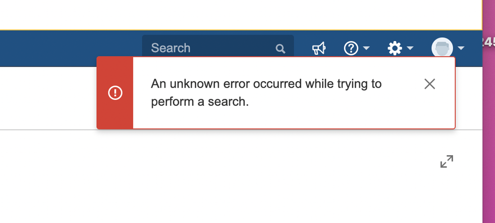

 When we attempt to search for various tickets, we received error notices (see screenshots “SearchError1” and “SearchError2”).

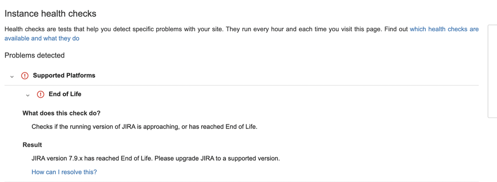

  • The first error showed that Jira version 7.9.x has reached End of Life and that we should upgrade (see screenshot titled “HealthCheck_EndOfLife”)

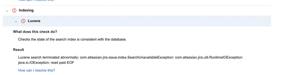

  • The second error displayed an Indexing issue related to Lucene. If you look at the screenshot titled “HealthCheck_Lucene,” you can see that that Lucene search terminated abnormally.

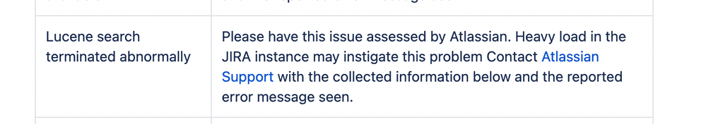

Searching for a way to resolve these issues, I looking into Lucene Search indexes and found this article. The one piece of information that stuck out was the Lucene search terminated abnormally. If you look at the screenshot titled “LuceneSearch,” I’m instructed to have this issue assessed by Atlassian. Heavy load in the Jira instance may instigate this problem.

Have you tried performing a reindex https://confluence.atlassian.com/adminjiraserver/search-indexing-938847710.html ?

However, i strongly believe that a full reindex following instructions in https://confluence.atlassian.com/adminjiraserver/search-indexing-938847710.html will fix the problem you see at this time.

This error can be caused by several things, but there is one that jumps out at me from your screenshots.
  • This can happen when the server is out of disk space (either literal space or inodes - check both with "df -kh" and "df -kih)
  • The server has run out of memory while running the indexing
  • And the one I suspect it is - Mariadb is not supported; it can give Jira corrupt data which it can't then write to the index
I would
  • Migrate to a supported database
  • Stop Jira after getting the new database working
  • Go into <jira home>/caches and move all the files and directories to a safe space outside Jira home
  • Restart Jira
  • Do a full locking re-index
