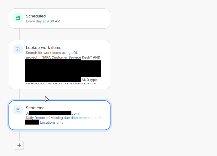

Firstly - I set up a Scheduled Task - every day at 9 - that part worked.
Secondly - I am using a Lookup JQL search and it worked - it gave me all matching tickets

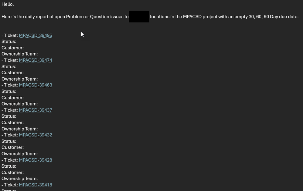

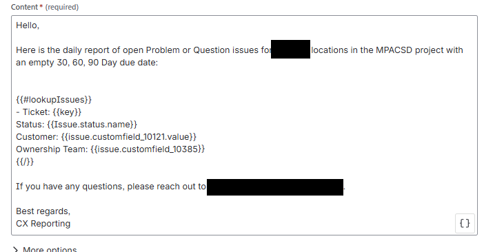

The problem I am having, is, it returns the Key  - but wont return anything else.Rule_automation.pngemailResponse.pngI am using the following to send the email - taking into account the loopupIssues tree, and it DOES return all ticket keys -- but it does not import any other fields.  I did try adding assignee into the mix and it DID work - so then I had Key and Assignee .. but cant figure out why I can not get any of the following, status/customer/ownership from fields.email format.png

Hi @Jeff Wieland -- Welcome to the Atlassian Community!
When inside the iterator for the lookup results, the issue prefix is not used.  For example:
{{#lookupIssues}}
* {{key}} -- {{summary}}
Kind regards,
Bill
Jeff Wieland
May 6, 2026
Thank you Bill! 4 hours of frustration with a "but it works everywhere else" not realizing you need to modify the "issue." prefix out of the smart values inside of an iteration statement!
