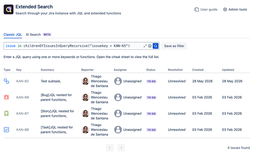

I’m Thiago, a support engineer at Appfire.
If you are considering third-party apps, you could also take the search a step further with recursive search using JQL Search Extensions(JQLSE).
To automatically find all subtasks, epics, and linked issues down the entire project tree, you can use a special function called childrenOfIssuesInQueryRecursive. Just replace KAN-65 with your specific issue key in the format below:
issue in childrenOfIssuesInQueryRecursive("issuekey = KAN-65")
If you want to combine multiple advanced queries together (nesting), JQLSE supports it with a quick two-step workaround:
  1. Save your initial search query as a Filter (e.g., name it "My Base Search").
  2. Reference that saved filter inside your final JQL search.
Please contact our support if you have any other questions about this.
Best regards, Appfire support team.
