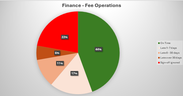

Hi There! I'm looking to build a dashboard compiled of charts for different fields. The goal os this chart is to look at the date the field was update to specific fields, compare them to a date within the JIRA, and bucket the timing into categories like [late] [on-time] [ignored] depending on how near or far the field update was made from the date field. Is this possible? Thanks!!2025-08-09_00-00-58.PNG

I agree with Trudy and Carlos - Jira does not have any built-in dashboard chart that can do this.
For some time we have use the Jira Custom Charts app to get better and more powerful graphs in Jira Dashboards. This app offers JQL to define graph segments - so you can choose a pie chart and use JQL to define what is included in each segment.
Their documentation briefly describes how to do something like what you describe.

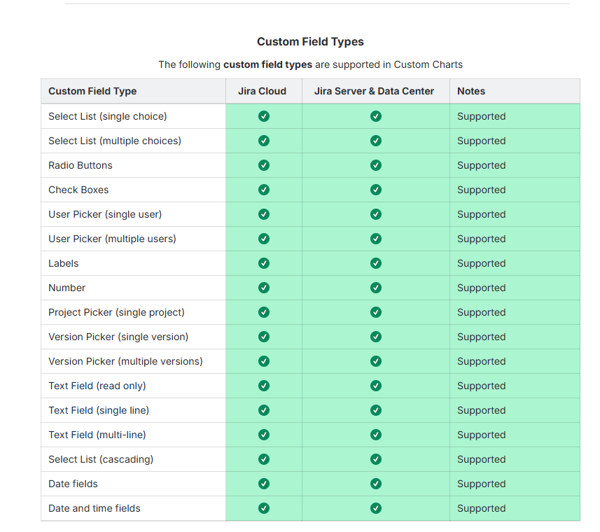

Thanks Dwight! I believe we currently use custom fields now but see that issue history isn't supported - Would you know if it's possible to2025-08-11_17-15-26.PNG create categories for custom fields based on the date updated to a specific field?

That’s a really interesting use case! While Jira doesn’t provide this report out of the box, I’m wondering if you could export the data to a spreadsheet (e.g., Excel) and then use formulas to calculate the numbers and create a chart similar to your example.

Thanks Carlos! Unfortunately, we are exporting the data now into a spreadsheet and doing the calculations manually, and thennnn creating the chart in powerpoint. Thanks again!

@Amanda Sugatan You could totally remove the manual work from your process and stay with Excel (if it is already working).
How?
The Better Excel Exporter app uses Excel files as templates. You place special placeholders, which will be replaced with the issue field values while creating the export file. You can even use formulas or define charts in the template, which will be filled with real data in the exported file! You have to create the template once, then fill it with real data with a few clicks any time.

Jira does not natively offer a report like that. It might be possible to create by combining a variety of custom solutions, like a custom field and Automation Rules to do the comparison and set the field.

It would not be an elegant solution. And I'm not sure I have fully grasped your scenario.
Could you possible walk through a specific example of how the report would be impacted by the changing of a field on a given date and the passage of time?
Also, how many fields of interest are there, where you would want to be able to generate these types of reports?
One solution would be to create custom fields that you could set to "on time", "late x days" values. For simplicity lets call those "timeliness" fields.
You could use Automation rules to detect changes to the fields of interest, execute the comparison of the current date of change to the specified comparison date, and set the associated "timeliness" field. Then build your chart based on the "timeliness" field. The "timeliness field would have to be a selection list type of field.
But if the scenario is one where the "timeliness" value would change as time passes and the last "date of change" remained unchanged, then the above is not quite the right solution.
Instead you might need date fields that correspond to the fields of interest. You would use Automation Rules to detect when the fields change and set their corresponding "date of change" field. Then use separate scheduled rules to review those "date of change" fields compared to your Comparison Date, and set the "timeliness" fields accordingly.
If you didn't want to add "date of change" fields then the solution would need to rely on the REST API to get change log information for each issue, find the change date information for the fields of interest, and do additional work to generate the "timeliness" value.
I suspect that there are 3rd party apps that would make this much easier, but I have not worked with many of the charting and reporting apps, so I don't have a specific recommendation on one that would suit your needs.

Great, thanks Trudy - we have about 27 custom fields we are looking to see when the fields were updated and compare to a 'due date' field. As I'm not the admin, we may not reach out to create an additional corresponding fields to the ones we already have. Thank you for your solution! If needed we will revisit!
