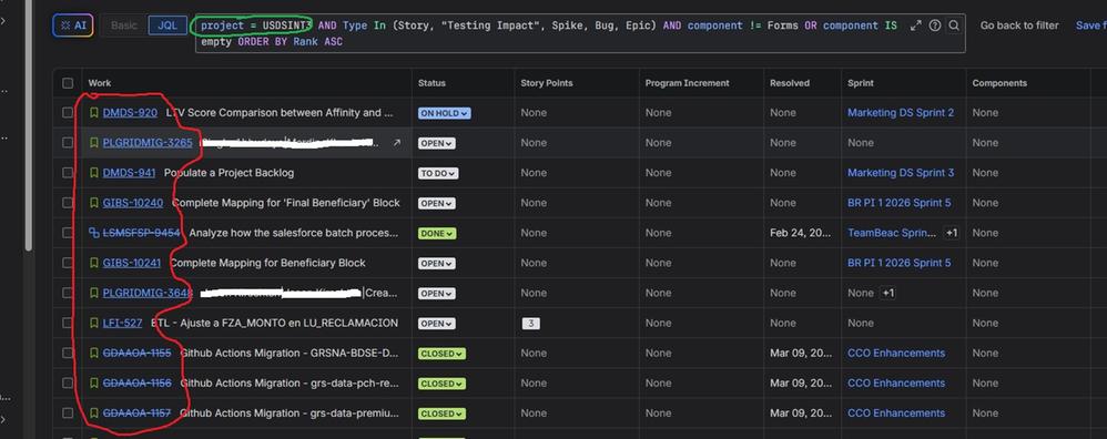

This is a view of the filter after I add the AND component != Forms OR component IS empty, didn't notice this before, but looks like it's ignoring the project key and just pulling in tickets from every project in the company with a blank component? The tickets below aren't in my project space. Maybe that's why the board view is crashing out and not displaying?
The filter and 1st board work perfectly fine when I remove the bolded piece.

Correct. The filter is working they way it should from the screen shot. The project should be there to reduce the scope of the filer.
The Filter you have in your JQL screen shot should have a parenthesis around the components statements. Otherwise, what the filter is doing is taking everything with the "AND" together to match...if it doesn't match it will just look at every component that is empty.
