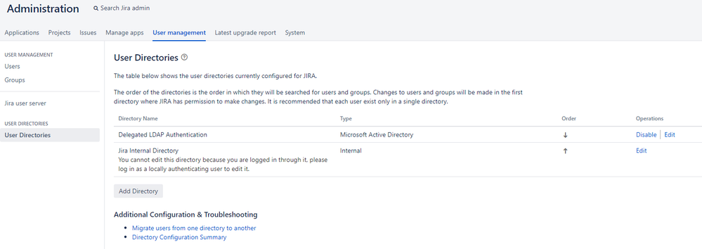

When viewing a user in Jira, the system says that the user is in two directories:
Screenshot of directories:

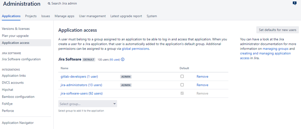

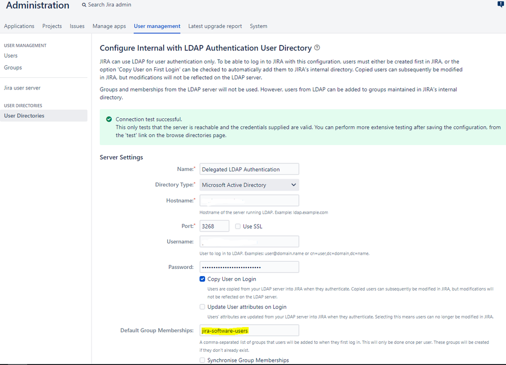

The above means the user does not have a valid application license. My suspicion is your LDAP configuration isn’t adding the newly created users to groups that grant them Jira licenses. Review your configuration here and you can find out which groups are allowed application access by checking the Application Access page as a Jira administrator. (Due to the different directory, Jira cleared the browser cookie)

Yes it will fail because that is not the password for same username in your LDAP. Fix the default group for users in your Ldap configuration to solve the problem here.
A simple hint, JIRA will pick a user based on username from the directory in the highest position, however, JIRA would still not grant the user the same permissions unless the user in both directories have the same group membership. Either by mapping the users to the same group from the AD or if you go with Delegated, mapping the users to internal groups. It wouldn’t automatically carry over.

Indeed, the user has lost access to the group that provides access to the application. added the user a group manually and the user is logged in.

default group for ldap assigned

It's all about which user directory the user belongs to first from top to bottom. If they have an account in both directories and you switch the order, they will have to use a different password and it will be a different account. Some content mapping for the user will remain but some won't - they are different accounts as far as Jira is concerned.

It is - it's basically the same as far as any other user directory goes, internal or external. The only difference between them is that internal directory is just built-in, and can't be removed itself, but other than that an account is "treated" the same way regardless of the directory it's in. (And again to re-iterate, if the same username exists in multiple directories, you will only be able to use the one that's from the first directory top to bottom, and it will have different group membership and userkey, different accounts at the end of the day.)
