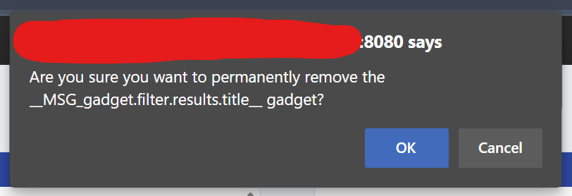

In addition, seeing this message if I try to delete a gadget.
