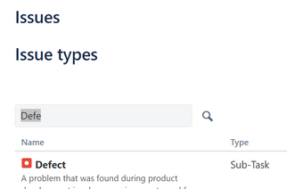

Actually, a sub-task is just an issue type as well. AND, your Defect issue type is probably already created as a sub-task type of issue type and not a standard issue type. If that is the case, then you can create the Defect just like you do a sub-task.

You might need to add the Defect issue type to the Issue Type Scheme being used by that project.

@aagrawal  - You should be able to click on the Create Subtask button and add it. If there is not a list of Sub-task types like Defect, then you need to add a Defect Sub-task issue type to your issue type scheme for that project.
