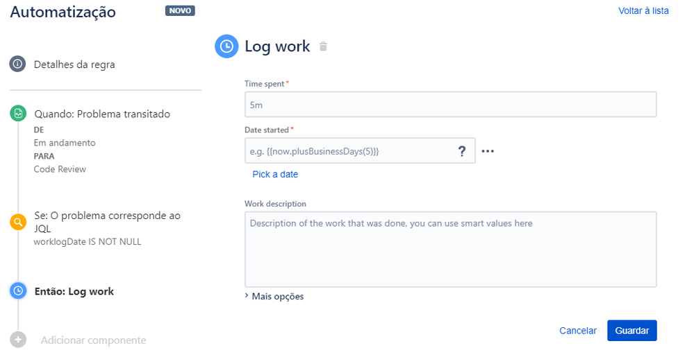

Hello!
Is there a way to force the user to log their work when transitioning an item? For example: whenever this user wants to move a task from "In Progress" to "Code Review", this user would not proceed unless the LogWorkDate field is fulfilled.
I took a look into the Automation settings, however the only option I cound find makes the admin to set the hours automatically, which not makes sense in my case because the log time will differ from task to task.
