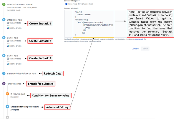

The main reason I need this is because I need to find specific child issues, by it's summary, so a can link it to another child issue. I was doing this using a Task and Subtask structure, and it worked, but now I have the need to do the same using Child and Parent relationship.
This is an example of how I've achieved it using Task and Subtask:
  • So I pretty much need a substitute for "issue.parent.subtasks" when using a Child / Parent relationship (from the Parent Link field).

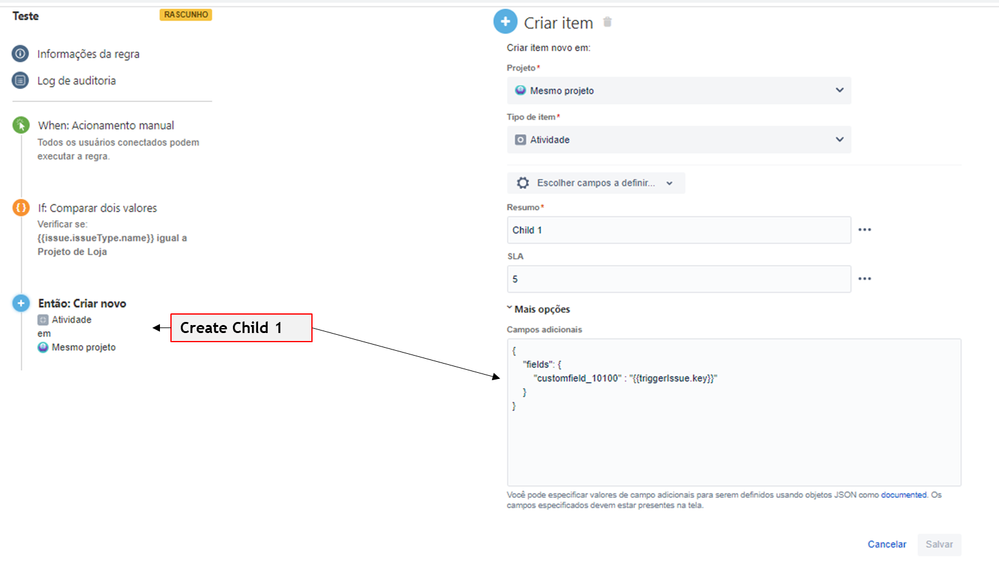

You are right, I took the same steps when working with the initiative/child structure. As follows:
  • First creating the child issues, using json and smart values to fill the "Parent Link" field with the trigger issue key: jira 1.png

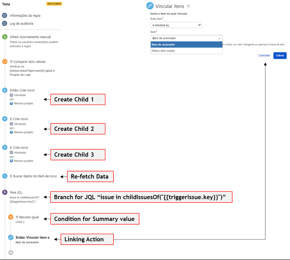

  • Then, creating a branch with the mentioned JQL, and adding condition to execute an action on a specific child issue:jira 2.png
I simply need to create a link between specific child issues. In the example, I would like "Child 2" being blocked by "Child 1". But the problem I find is that the linking action in Automation will only let me link it to the las created issue or the trigger issue. I will have multiple links, working as dependencies, that's why I needed to "look up" for all child issues and check the ones that match my condition to create the link. I'm able to to that in the subtask structure, because I can use json and smart smart values to get all the subtasks of the parent ("issue.parent.subtasks") and create the link. I can't find something similar to get all the child issues, other than the mentioned JQL, and neither can I have a branch inside a branch, which would probably solve my problem as well.

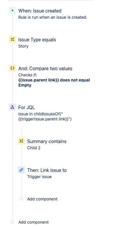

Trudy P Claspill
December 29, 2022
Have you considered having a separate rule to create links between the child issues of the Initiative?
You could create a rule that triggers when a child issue of the appropriate type is created. Add conditions to confirm that it has a Parent Link, and that it has the summary of one of the two issues that needs to be linked.
Then do a Branch to retrieve all the child issues of the specified parent.
Within the branch use a condition to find the child issue with the summary of the issue needing to be linked.
Add an action to create the link.
This is from Cloud, but it would look something like this. You would need to fix the values in the Condition components to match your needs.
