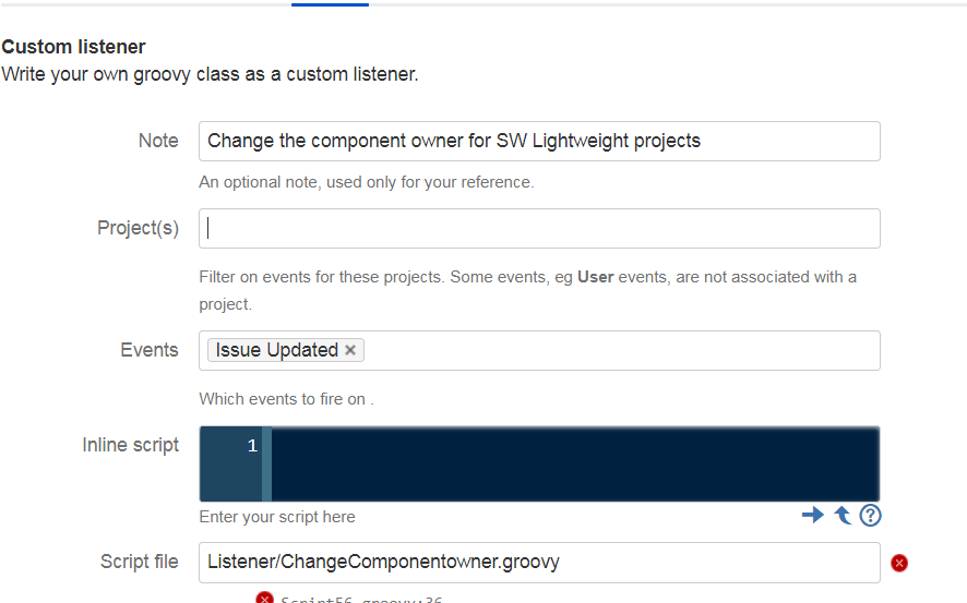

@Vineela Durbha could you please provide a screenshot of you configuration / script ? It would be easier to debug it.
Vineela Durbha
December 4, 2019
@Antoine Berry
Please find the attached screenshot . I have tried not to mention any project under projects and because of this assignee value is not getting changed inspite of mentioning that in the script. My script is as below

This works only if I mention specific project under projects in Listener UI. But when i try to display the assignee value in the script, I can see the new assignee but the value is not being reflected on UI. So I guess value is getting changed but not being reflected in UICapture.PNG
Antoine Berry
December 4, 2019

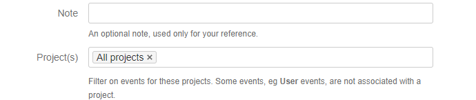

With that current configuration the listener will indeed not execute, kindly try to map it with all projets :
Vineela Durbha
December 4, 2019
@Antoine Berry

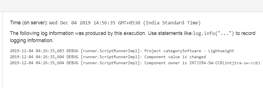

With All projects it is not working. I can see that script got executed successfully, but on UI assignee value is not changed.Capture.PNG
Antoine Berry
December 4, 2019
If I am not mistaken the script should display the assignee if it is updated ?
