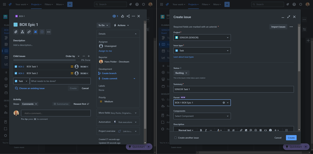

Let's go back a bit. In the end, you want the option to have a ticket in the SENSOR project that can be linked to an Epic in the BOX project.
Option 1: Do it manually. On the left, you see the BOX-1 ticket which is an Epic, and has 2 BOX Tasks (BOX-2 and BOX-3). On the right, you see the SENSOR project in which I am creating a Task manually, filling in the 'Parent' field as 'BOX-1'. It will then be shown as yet another child of the BOX-1 epic.

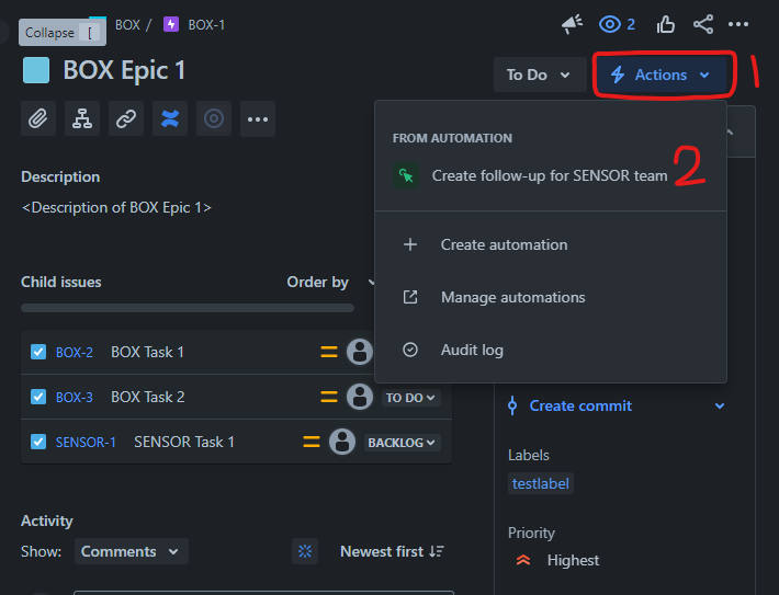

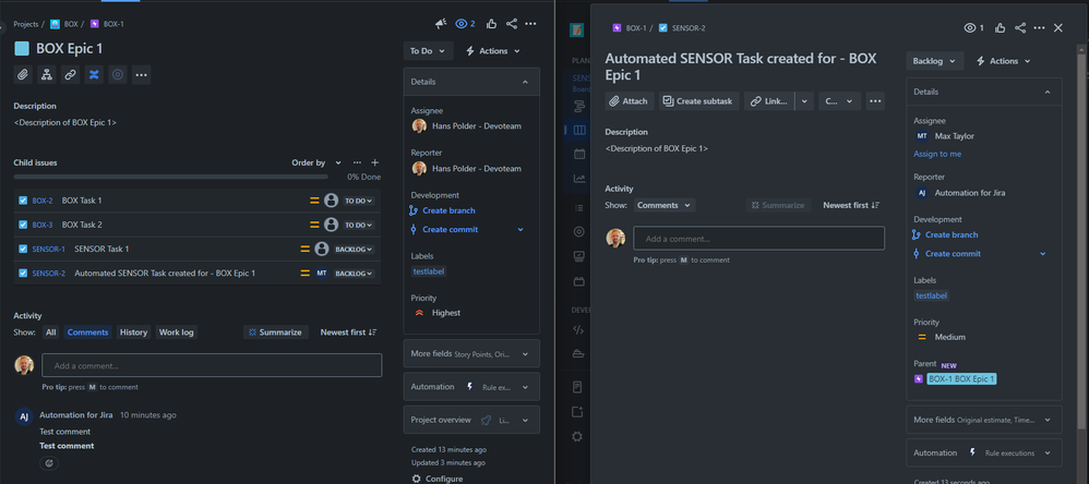

Option 2: We create an automation rule that allows people to create a follow-up task in the SENSOR project with information automatically copied from the BOX ticket. This will create a ticket in the SENSOR project with some information preset (for instance: I copied the labels from the Epic, made it child of the Epic in question, Assigned to 'Max Taylor' and copied the description from the Epic. Also, I set the summary as standard text + the Summary from the originating Epic. See below:
Above option is enabled by creating a manual-trigger Automation in your project (which you can tweak/setup to your liking):
Result:
