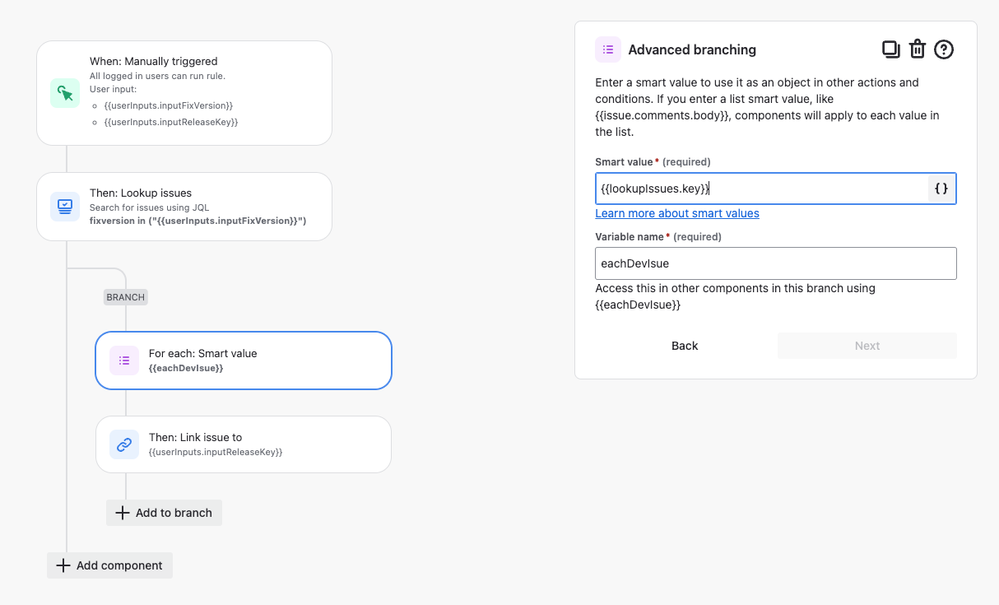

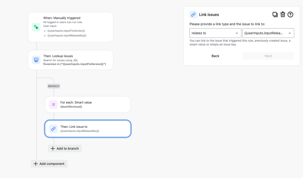

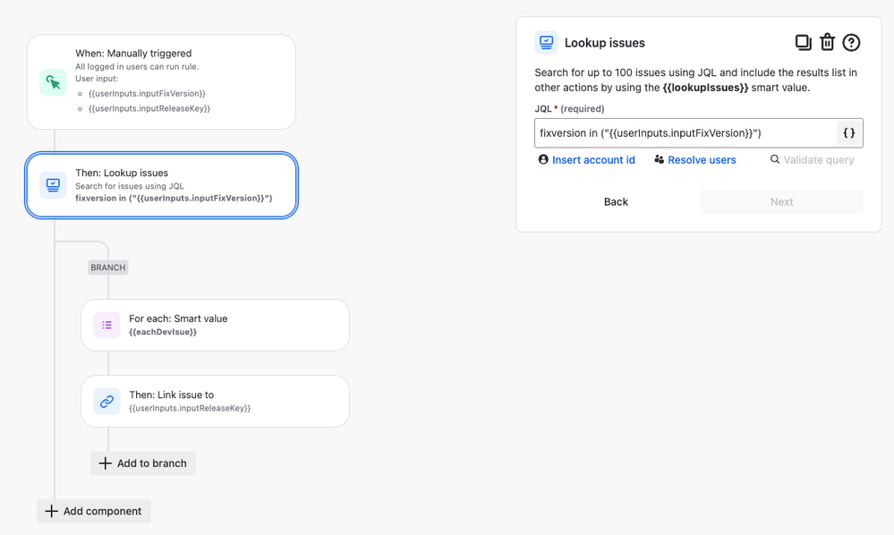

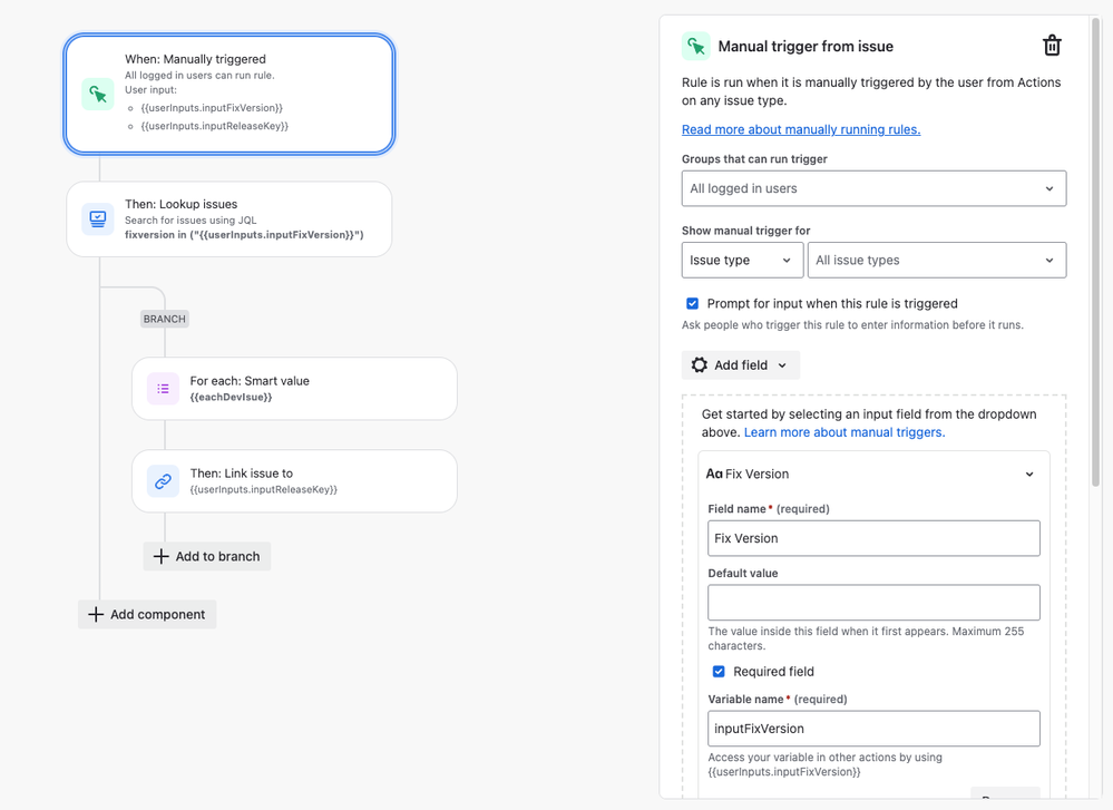

Natively, the only method to do this would be to use an Automation Rule. In the rule you could execute a search for the Development issues and then loop through them to link each one to the Release issue.
If this is a task you need to do repeatedly for different Fix Versions (sets of Development issues) and different Release issue, you could create a Manually Triggered automation that prompts for input. The Input could be the Fix Version name and the Release issue key. Those inputs could be used in the rule to execute the search for the Development issues and then specify the Release issue to which they should be linked.
Screenshot 2024-12-20 at 9.31.35 AM.pngScreenshot 2024-12-20 at 9.31.46 AM.pngScreenshot 2024-12-20 at 9.31.56 AM.png
