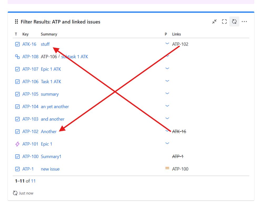

For example
i created a dashboard S&R priorities ....
In the dashboard i added gadget ' Filter result' where you must add a filter. In that filter I was able to fetch the data you see in first screenprint, so that leads to KEY (link to first line ticket, see red number 1) and LINKS ( link to second line ticket, see red number 2)
So i can fetch first line ticket info and only LINK to second line ticket

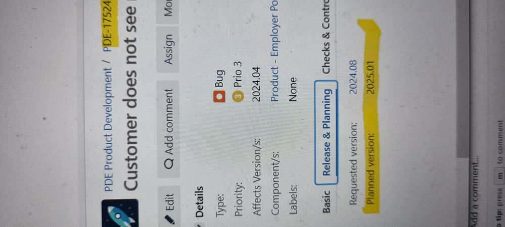

In this dashboard however I also want to see more info available in the second line LINK PDE- tiicket
for example the value of field 'Planned version' and 'Requested version'  shown in second screen shot
Will this info give more explanation of my needs?
Trudy P Claspill
January 19, 2025
The Links column is displaying just the keys for all issues linked the issue identified in the Key field.
What is the filter you are using for this gadget?
I believe that the filter you are using is actually only retrieving the issues that are listed in the Key column. For each issue the keys for linked issue can be obtained from the Linked Issues field. No other data about those linked issues will be available.
If you want details of both the first line ticket and the linked second line tickets you will need to use a different filter that leverages a third party app the extends the JQL capabilities, such as the app I named in my previous response.
The results of such a filter would include all the first line tickets and the linked second line tickets. The details of each of those issues would display in a separate row in the Filter Results output.
Here is an example of such results. The details shown in the rows are for the issue named in the Key column. Notice that issues listed in the Links column are listed in rows of their own.

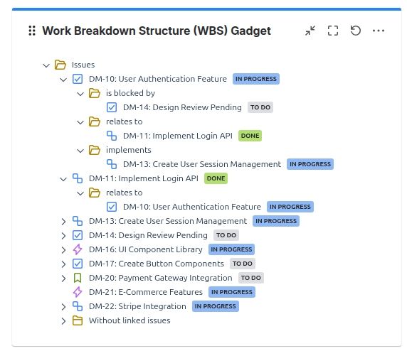

Hi @Ronald,
If you are willing to try an app from Atlassian Marketplace, you can get the issues from a filter/JQL displayed along with their linked issues by using the Work Breakdown Structure (WBS) gadget offered by our Great Gadgets app.
Danut
