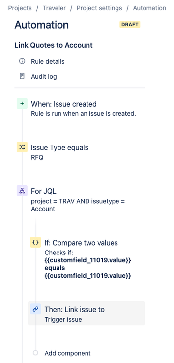

we have the following problem, maybe someone can help us.
In our project, a ticket with the issue type RFQ is created via automation. We want to link this created ticket to another (already existing) ticket with the issue type Account via automation.
To do this, we have built an automation that compares the values of two custom fields stored in both RFQ and Account. If the value in these custom fields is identical, the two tickets should be linked.
Unfortunately, all tickets of the issue type account are linked, not just the one that has the same value in the custom field.
Does anyone have a suggestion on what might be the problem here? See the automation below:

Hi @Tobias Koch
I believe the issue is your comparison is comparing the issues in the branch to themselves, rather than to the trigger issue.
If you want to compare to the trigger issue, change your advanced compare to testing {{issue.customfield_11019.value}} equals {{triggerIssue.customfield_11019.value}}
Or better still...change your branch JQL to find only what you want:
project = TRAV AND issueType = Account AND name-of-your-custom-field = {{triggerIssue.customfield_11019.value}}

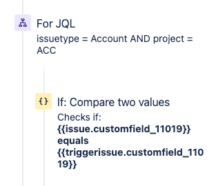

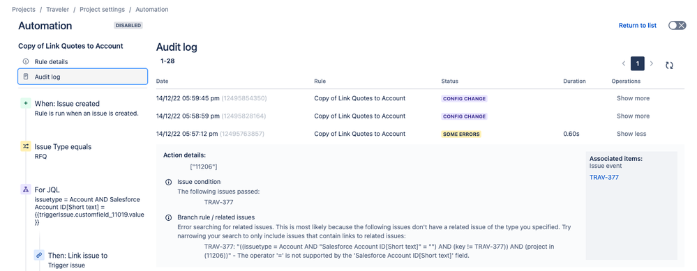

Hi @Bill Sheboy thanks for the tip! I already tried it with the JQL branch you recommended.
Unfortunately, I receive an error when the automation runs. Do you have a guess why that could be the case?

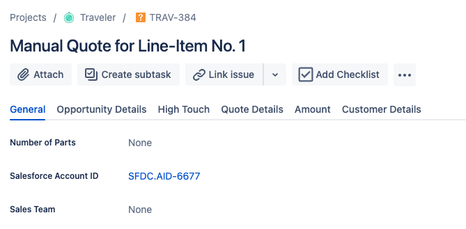

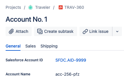

The updated compare is also not working. The problem is, that only one of the Accounts (from TRAV-360 to TRAV-338) has the same value as the RFQ, however, all of them pass?

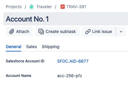

As you can see, only one of the Accounts has the correct value in the Custom Field Salesforce Account ID, however, both of them are linked.

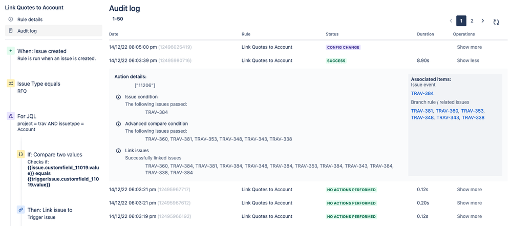

@Tobias Koch , +1 to @Bill Sheboy  view. By looking at the status "No Action Performed" in the logs, seems like Account issues and RFQ issues are being created at the same time
which does not give enough time to execute the rule properly.

I was able to fix it now with the {{issue.customfield_11019}} in the first field of the If: Compare two values and {{triggerissue.customfield_11019}} in the second field.
This is what I see in the Audit Log. The problem is, that only one of the Accounts (from TRAV-360 to TRAV-338) has the same value as the RFQ, however, all of them pass.

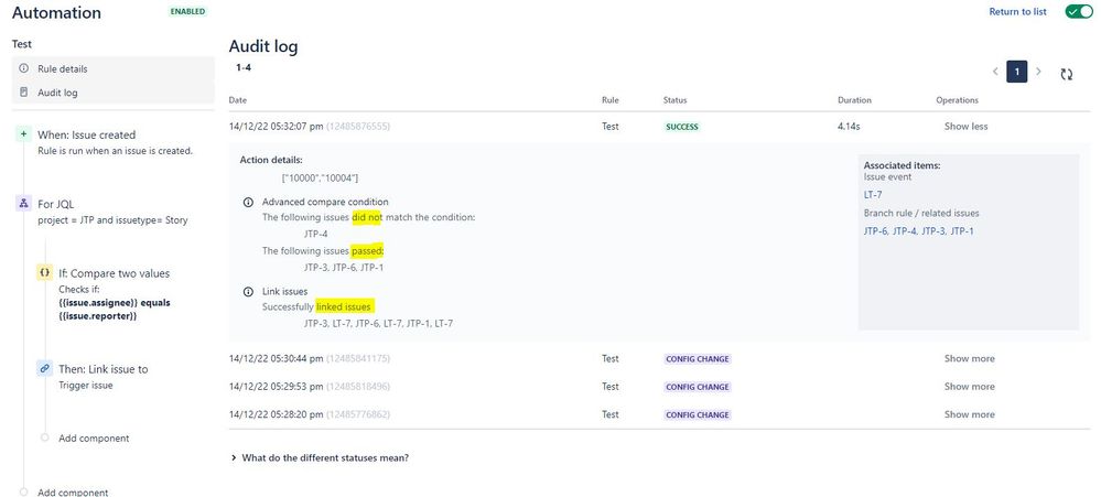

Vedant Kulkarni_Trundl
December 14, 2022
@Tobias Koch , I have created a similar rule in my test instance and tried it, it worked as expected. Can you check your audit logs
