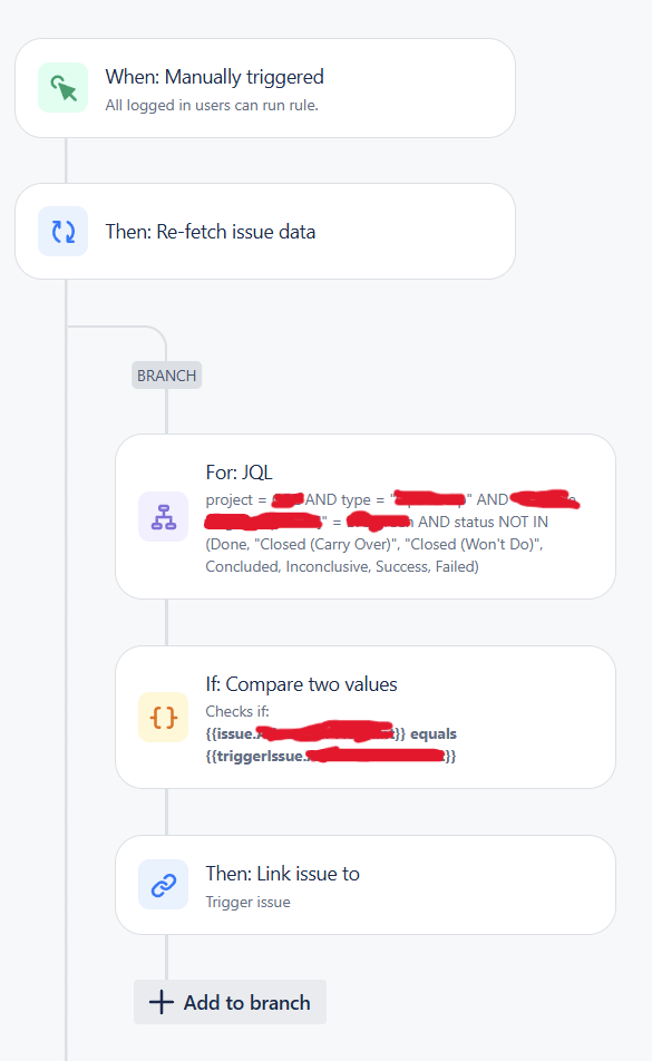

So far I have managed to create an automation that can link Linked Issue 1 to Linked Issue 3 but it has to be triggered on the linked issue but not the main Issue with all the target linked issues. See the screenshot below:
Automation:
  • Manually triggered on Linked Issue 1
  • Links Linked Issue 1 to Linked Issue 3
I'm hoping to add on to it so I do not have to manually go into each linked issue to trigger the automation but just have it trigger on the main issue all relevant issues are linked to. Is that possible to do?

I am using a different custom field in the JQL to determine the list to link to in the above automation but other than that, no other relations.
I have but that again was on a issue by issue basis, I was not able to make it so that it's linked issues in Issue 1 to linked issues in Issue 2.
