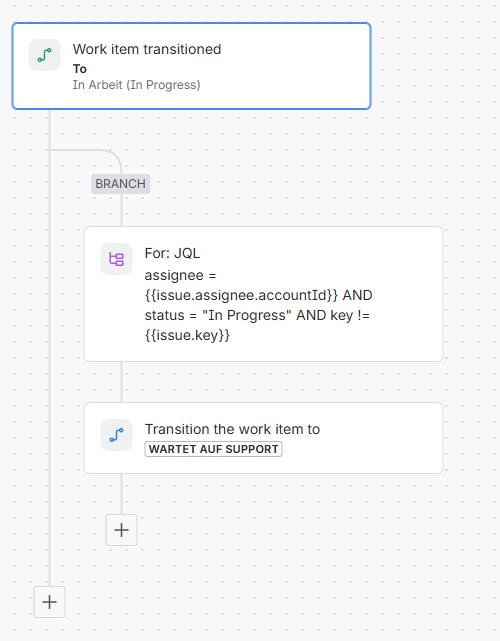

Hey Ivan,
this looks like a perfect fit for a Branch Rule.
Automation Summary:
Trigger: Work item transitioned to "In Arbeit (In Progress)"
Branch: For JQL — find all OTHER tasks of the same assignee that are currently "In Progress":
assignee = {{issue.assignee.accountId}} AND status = "In Progress" AND key != {{issue.key}}
Action: Transition the work item to "On Hold"
Keep in Mind, that the Automation needs to have Permission in the Workflow to transition the issues from "In Progress" to "On Hold".

Niklas Maier _KUMAVISION AG_
June 15, 2026
the automation in Jira:

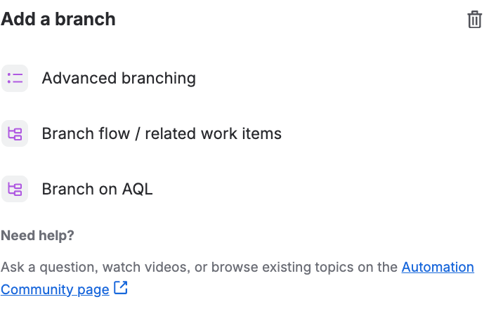

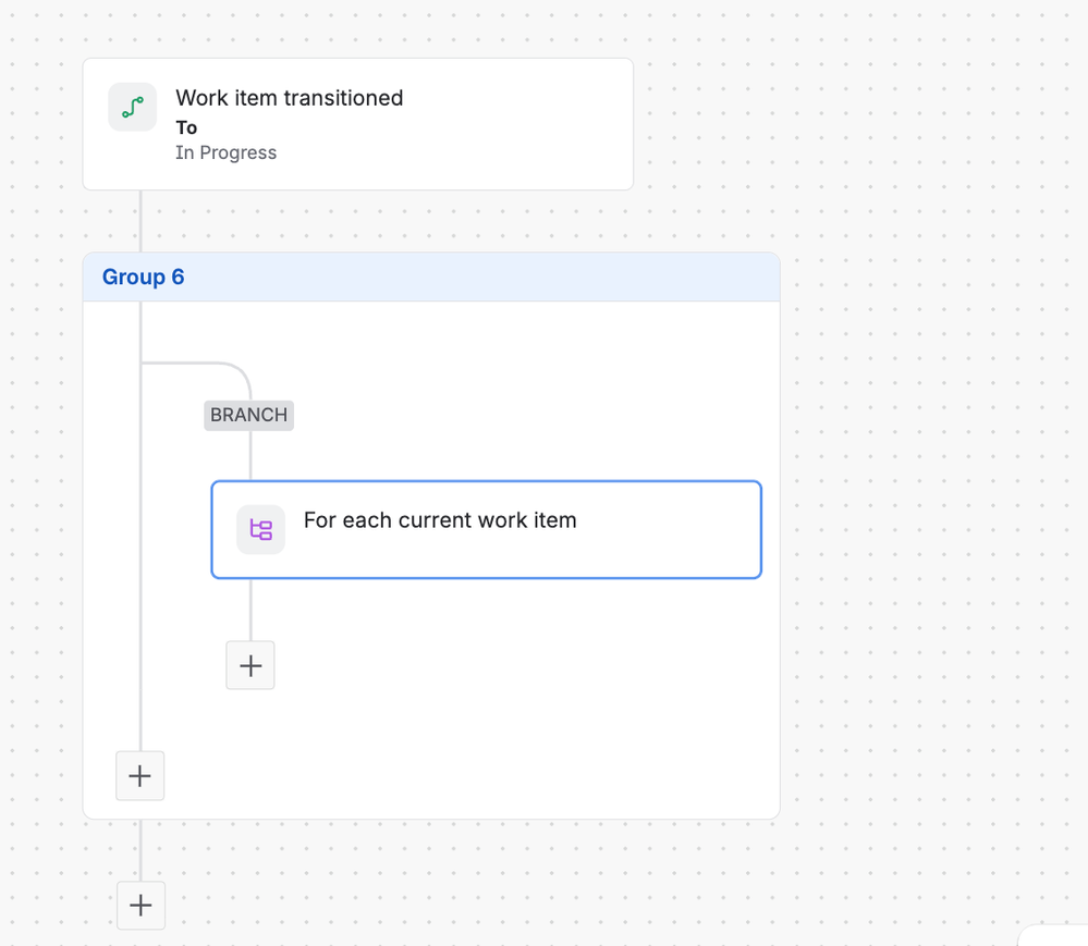

@Niklas Maier _KUMAVISION AG_ Hello, thanks for your help, I have a few questions. Please help me
What kind of branch I have to choose? And why this group was created?
Ivan Andrieiev
June 16, 2026

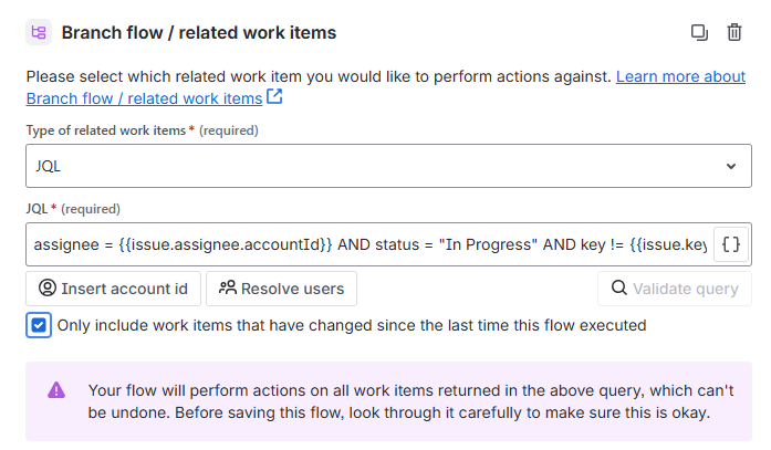

Hey Ivan,
you have to use Branch flow / related work Items and catch the JQL Option
here a detailed picture of the Branch Config:
the Branch is created to perform the Transition Action on all Work Items which follows the Branch Filter specified with JQL, which in your case, are all Issues assigned to the current assignee, in the Status "in Progress" and don't have the same issue Key like the one triggered the Automation.
