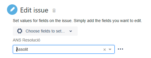

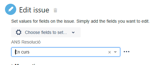

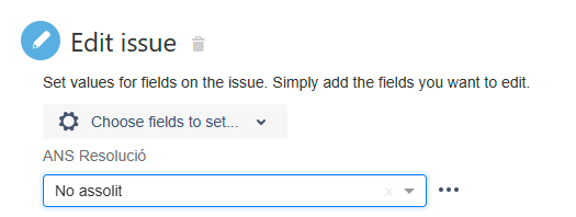

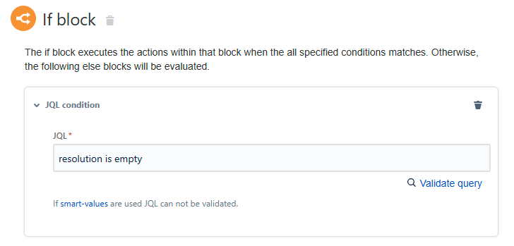

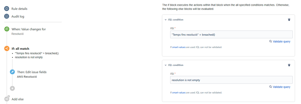

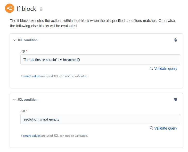

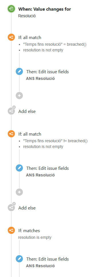

I believe I’ve finally managed to replicate the intended behavior from Legacy Automation using the new Jira Automation system. I’ve structured the rule with three separate if conditions to cover all possible resolution changes, and the results seem consistent with what I expected.
Could you please take a quick look and let me know if you also think this approach is valid?
First if:
Second if:
Third if:

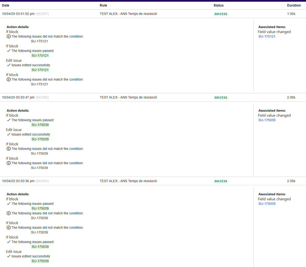

Audit Logs
I've also included screenshots of the audit logs from test executions, which confirm that each condition triggers correctly depending on the resolution change.
It looks like I’ve got the behavior I needed in all scenarios, but I’d love a confirmation from your side in case I’ve missed anything subtle.
Thanks again!

Complete scenario:
Bill Sheboy
April 10, 2025
That looks correct.  Does your testing confirm all the cases you want to handle?
Àlex Costa
April 10, 2025
Yes, I’ve tested all the scenarios, and everything is working exactly as expected now!
