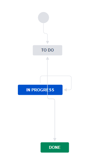

I could create new step/status "In Progress" but it is not linked between "To Do" and "Done". HOW to link them, when arrows doesn't allow to connect steps...
Note, new step "In progress" is now visible on "Board" but I couldn't move there any task!aaa.PNG

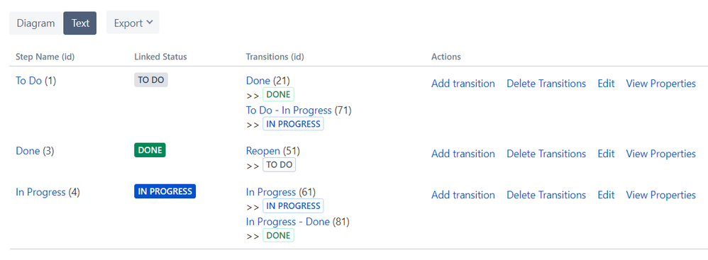

I have a huge mess here...I made these relations and don't know what's going on, b/c it still doesn't link three steps in that way: TO DO - IN PROGRESS - DONE.aa1.PNG
Nic Brough -Adaptavist-
May 6, 2021
Actually, it does.  From To-do, you can go to in-progress.  From in-progress, you can go to done.  The diagram it generates might not be clear, but reading through the transitions tells us that you do have a  To-do -> In-Progres -> Done path.
You have extra transitions though - to-do straight to done (not a problem, useful for when you identify that an issue doesn't need any work), Re-open from done (which also makes perfect sense for when you've closed something that turns out to need more work), and in-progress -> in-progress.  I can't give you an obvious and generic reason for adding a transition back to the same status, but there are perfectly good reasons for having them.  You may not need it through, so I'd be tempted to delete that one.
