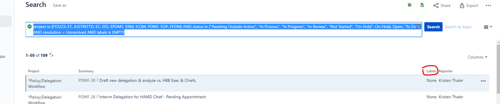

Can anyone help my report correct this issue?

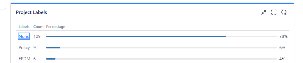

Filter shows labels as NONE when the issue has content in the Labels Field.
This is giving erroneous reports in the LABELS Report.
project in (FY2223, ET, JUSTINTTD, EC, EES, EPDM1, ERM, ICOM, PDWF, EOP, EPDM) AND status in ("Awaiting Outside Action", "In Process", "In Progress", "In Review", "Not Started", "On Hold", On-Hold, Open, "To Do") AND resolution = Unresolved AND labels is EMPTY

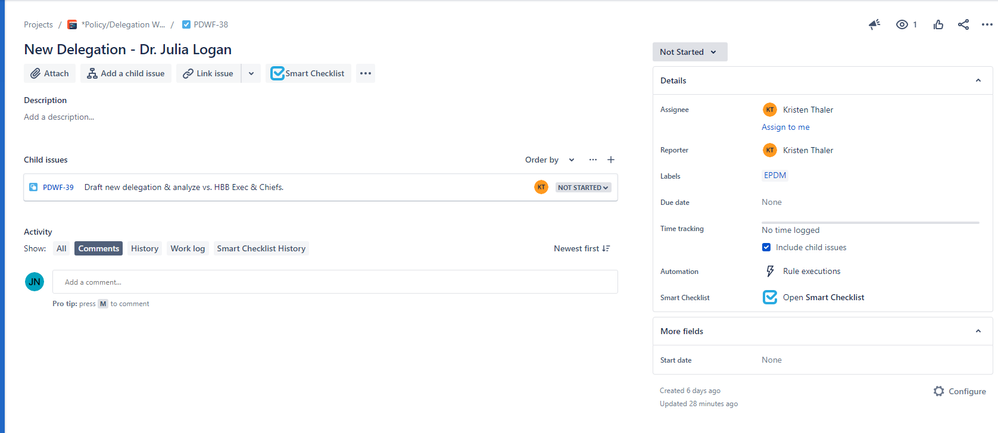

I Need to know why a project that has a label, see image 2 with EPDM as label, but it is in the results of the filter, and therefore on my dashboard report.
Benjamin
June 28, 2022
Thanks @Jason Newman .
The ticket you are looking at is not the same one in your list. The one on your list is actually the sub-task which is PDWF-39. Add a column to your issue list called "key" and you will see this visually.
-Ben
Jason Newman
June 28, 2022
ah, LIFE SAVER.
It was the child issue that did not have a tag!
Or Layer 3.
I will adjust these. Thank you.
