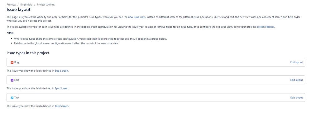

Trena Norcia
October 3, 2020
I have added it to issue layout in the project:

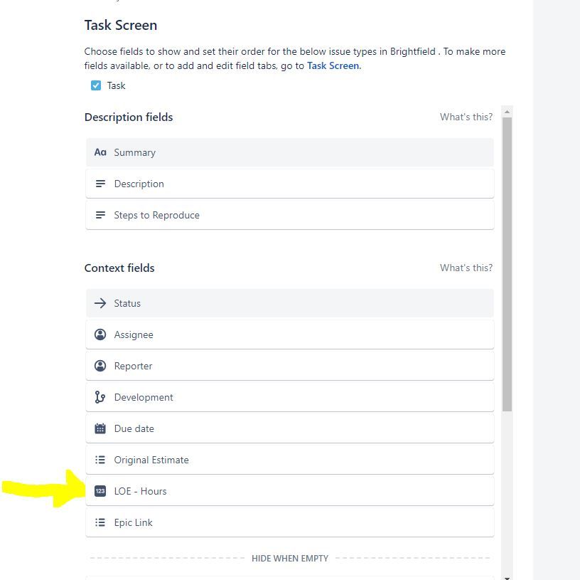

Trena Norcia
October 3, 2020
and to the screen:

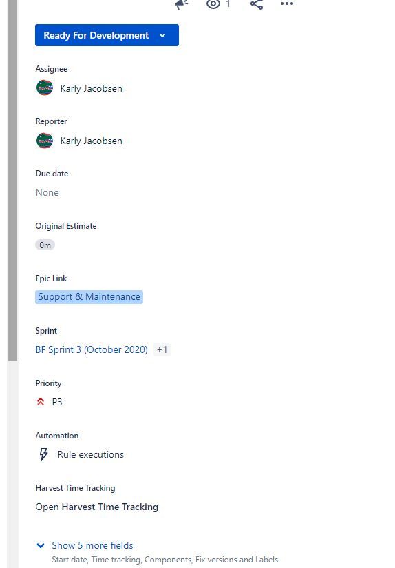

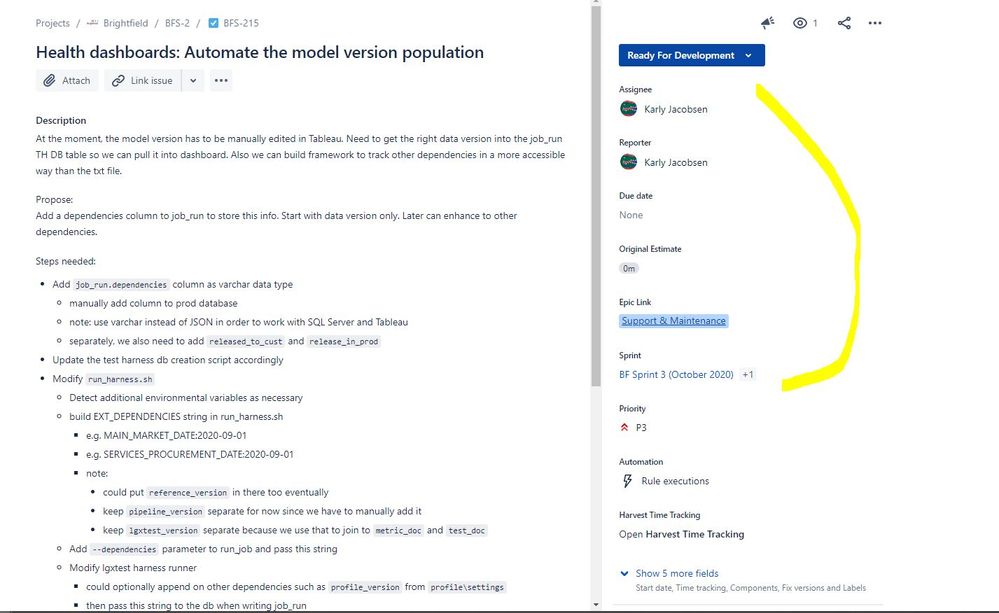

Trena Norcia
October 3, 2020

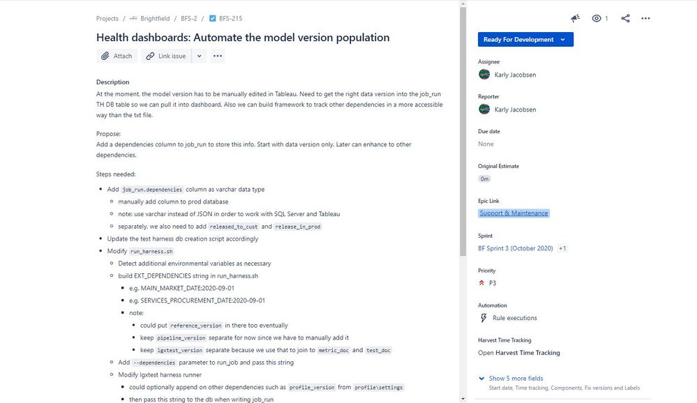

There is not an edit option:

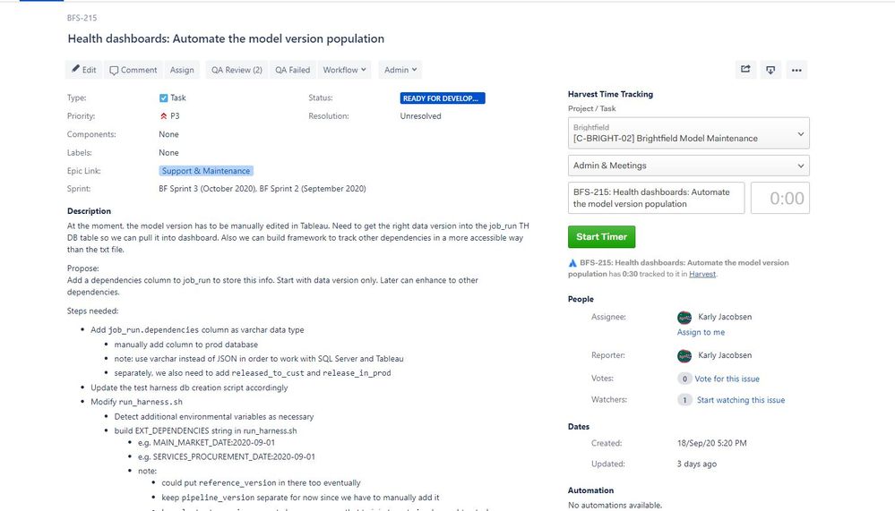

Nic Brough -Adaptavist-
October 3, 2020
Click on the issue, then use the menu option for "see the old view"
This is one of the reasons I don't think the new issue view is ready to replace the old, it's missing so many functions.

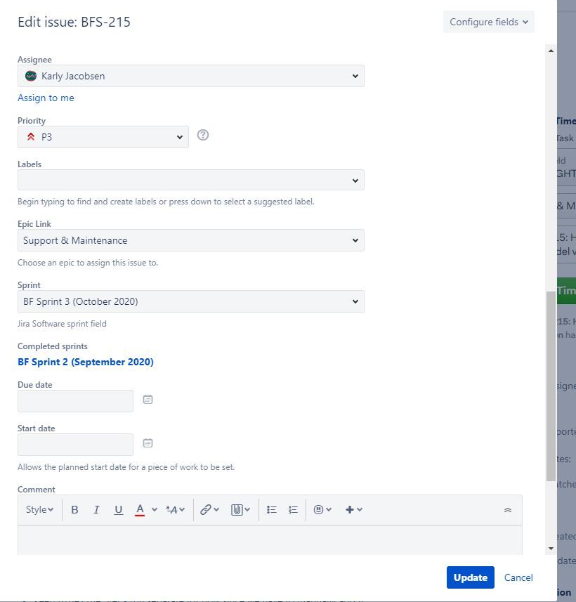

Trena Norcia
October 5, 2020
Thanks for all your help with this when I follow those steps it does bring up LOE it brings up time tracking and I am thinking it is because I have Jira linked to harvest time tracking?
harvest.JPGSelecting edit still does not show LOE field as an option?
I am open to trying an other ideas?  I really need LOE to appear it is how we are assigning the time to plan for sprints?
