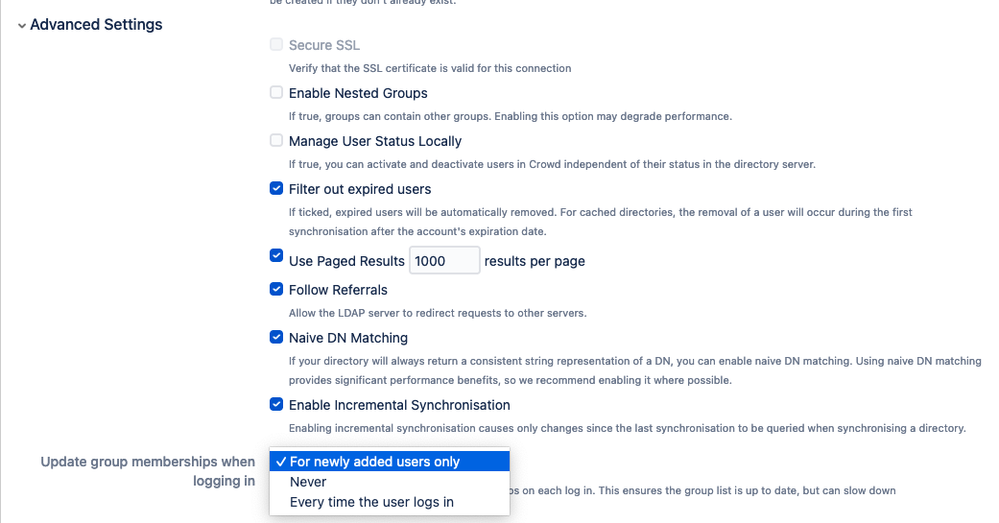

I believe what you are seeing is your LDAP is in periods overloaded and not able to answer queries and gives “connect timed out”. This could be caused by your LDAP directory settings where it by default is set to "Update group memberships on each login". Since Jira queries the LDAP server upon each login of all your users, this will put a lot of traffic towards the LDAP server.
A solution we have found to avoiding such problems is changing the user directory configuration “Update group memberships when logging in” and setting this to either “for newly added users only” or “Never”. This will mean that user login will not update group memberships. Memberships will then only be updated on each sync interval (which is by default every 60 minutes). We have seen that this is a satisfiable solution for several of our clients.
Please try this for your user directory that is failing and report back. Hopefully, this will make logins more stable.

SaSu June 23, 2022
Hi Elias,
thanks for your response. We already did what you wrote and there is no real change.  We are now in communication with the atlassian support team. Thanks a lot for your answer.
