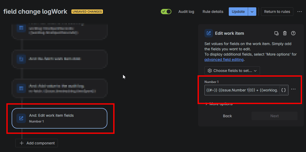

I just did a quick test rule and as far as I got you right it does the job.
The trigger is a "work logged" trigger with "work log created" action:
This means it will run whenever a new working time is logged. The trigger allows to get the amount of time logged with the smart value {{worklog.timeSpentSeconds}}
Afterwards I add the amount of logged time to my number field (see screenshot):
The whole calculation statement within the edit issue action is:
{{#=}} {{issue.Number 1|0}} + {{worklog.timeSpentSeconds.asNumber}}{{/}}
In case your users are allowed to delete their worklogs you could create another similar rule with the same trigger but with "delete" action and then substract the time logged.
Furthermore another rule needs to be created that "resets" all issue´s number field when a sprint is closed so that you start from scratch in the new sprint.

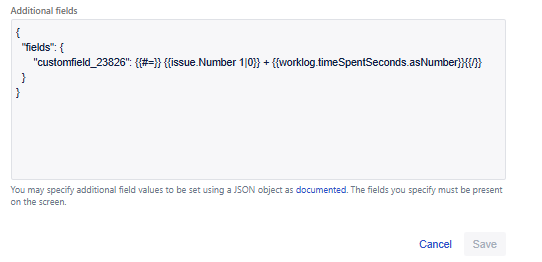

Gor Greyan
July 28, 2025
Hi @Stefan Salzl

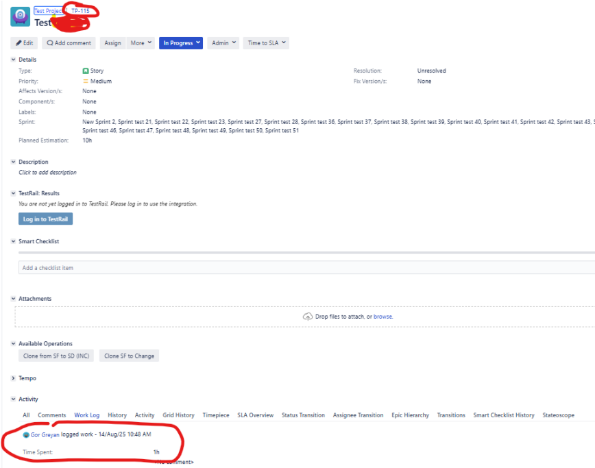

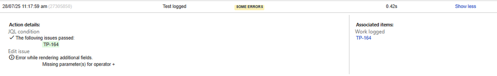

Thanks for the detailed information. But unfortunately, I received the following error. See the attached screenshot.
Stefan Salzl
July 28, 2025
Hi @Gor Greyan
Did you set up the rule exactly as described i  my previous post? As the audit log shows any JQL action it seems (without seeing details of the rule) the trigger is not a worklog trigger. Am I right?
If so the {{worklog}} smart value is not available. This special smart value refers to the special worklog trigger and can only be used in such a rule.
Best
Stefan

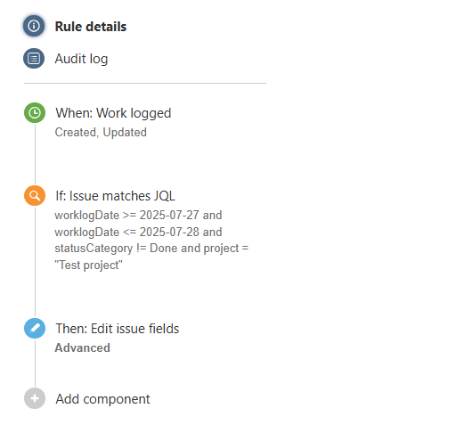

Yes, the trigger is Worklog creation, and I had a JQL condition, which checks that the worklog is done during my sprint dates.
Below you can find my automation structure.

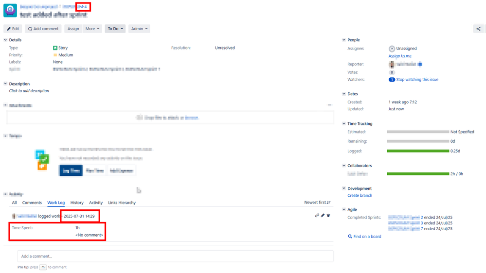

Gor Greyan
July 31, 2025
Hi @Stefan Salzl
You provided solution is from Jira Cloud, as I mentioned, I am using Data Center. Also, I provide the example, where in the Data Center you provided Documentation didn't work. I provided the error message, which I received.
If you can help regarding that error, thank you; if not, please, don't say that I require ready-to-go solutions.

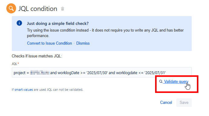

Regarding your JQL Problem:

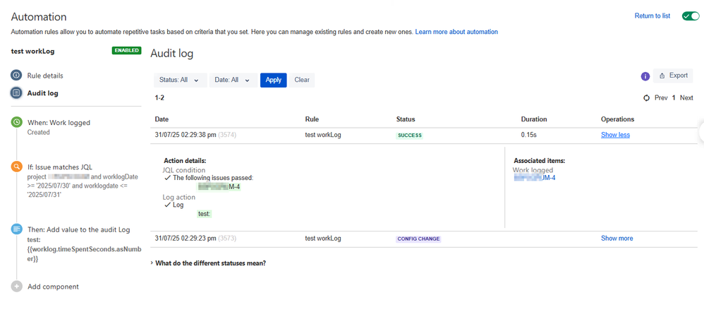

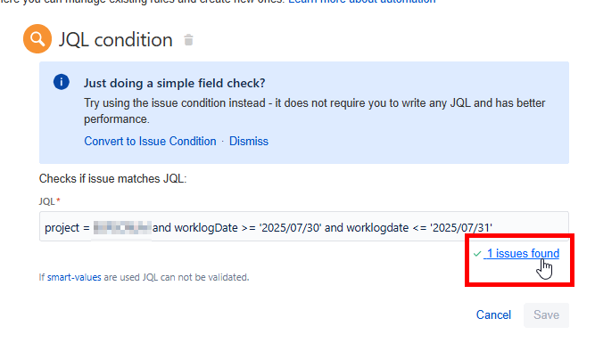

My fault, didn´t see that it´s DC. I created it in DC too. Did you try to set the date into quotation marks? And furthermore did you try to validate the JQL in the condition-copmponent? (see screenshots)
Please let me know if this worked/helped.

Gor Greyan
August 13, 2025
Hi @Stefan Salzl
Sorry for the late response. I was on my vacation :)
Thanks for the detailed explanation.
I tried that way, but still no success. See attached screens.
But I tried {{worklog.timeSpentSeconds.last}} and it returned only the last logged time. I think there is any way to find solution :D

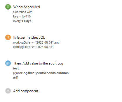

According to your screenshot you changed the trigger in your automation to a scheduled trigger. In this case the {{worklog}} smart value is not available in/in scope of your automation rule. This smart value will only work in combination with a worklog trigger. But it seems the jql condition was working correctly this time :)

Gor Greyan
August 19, 2025
Hi @Stefan Salzl
Yes, JQL is working, but the log work didn't return anything, despite the fact that I changed the trigger to Work Log Created.

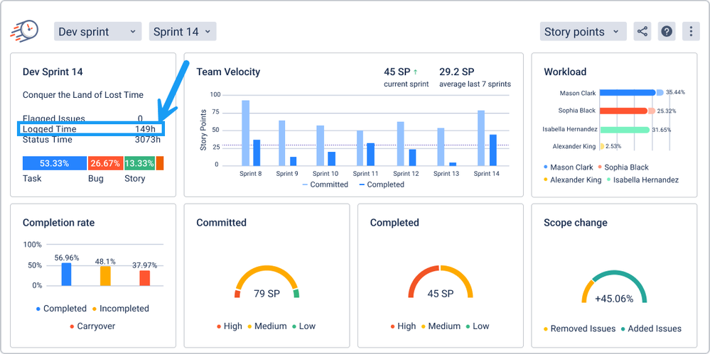

Iryna Komarnitska_SaaSJet_
July 24, 2025
Hi @Gor Greyan ,
Our app, Time in Status by SaaSJet, currently cannot populate a custom field with logged time filtered by sprint. However, we do provide this data within the Sprint Report, where it’s calculated like this:
Logged Time – The total time team members spent on each work item during the sprint, based on worklog records between the sprint’s start and completion dates.
So, while you can’t push this data into a custom field at the moment, you can still view the precise sprint-based logged time through our app’s Sprint Report section.
Gor Greyan
July 25, 2025
Hi @Iryna Komarnitska_SaaSJet_
Thanks for the provided solution.
But does it provide information per ticket?
I need this at the ticket level
