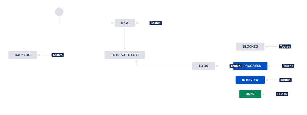

So here is my workflow:

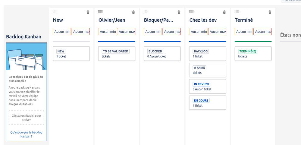

The first board for the "business"

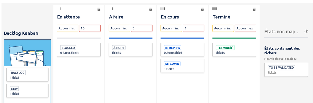

The second board for the "dev" (the only one that have a backlog screen) :

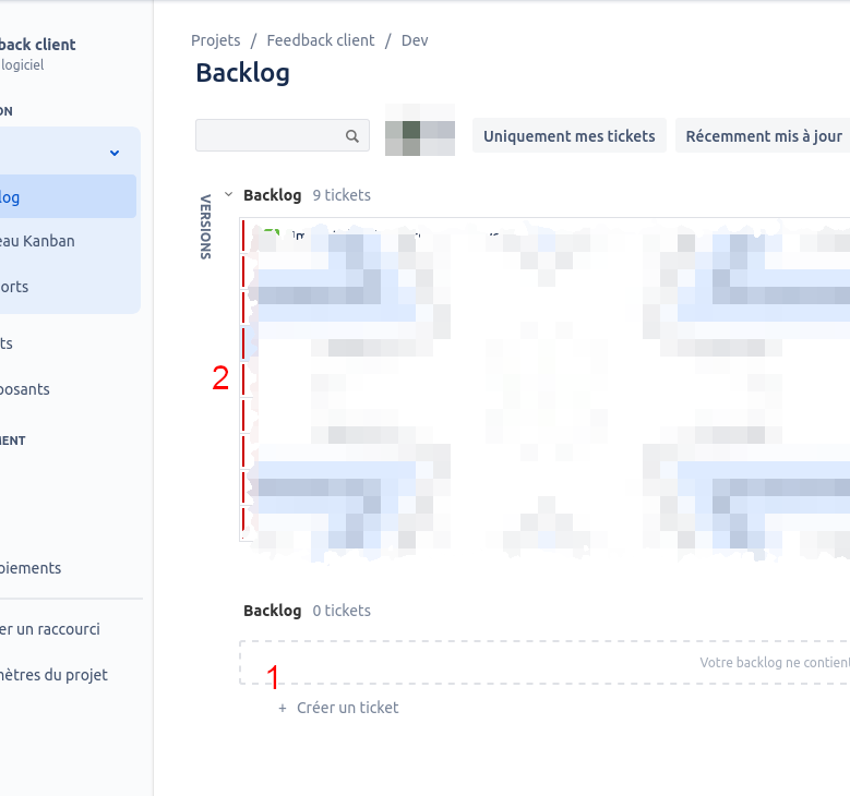

The problem I have, is that when the first process end (so change the status of a new ticket), and the discussion with the BU has finished, we need to put the ticket inside the backlog as backlog status (except some ticket that go directly to "to do") but not in the backlog part but in the ready part (so the top part of the backlog screen).
I have another issue, when I move an issue from the backlog to the top part (ready) the status of the issue change to "blocked".
So is there a way to transition a ticket from any status to ready in the backlog?
How can I change the status that are automatically set of the ready element in the backlog?

Map out the lifecycle of your issue first.  Pretty much do what the workflow diagram you've shown us is.  Is that diagram correct?  Does it show all possible flows for your issues?

thanks for the answer, but it didn't really help. The workflow seems fine and the board too. The problem are related to sending an issue to the "ready to use" part of the backlog, with a transition. And when I manually move an issue from the backlog to this part, it's changing it's status to "blocked" for no reason...

Ok, that tells me your workflow is not built to do what you expect, it's broken (or has misleading names on the transitions)
You'll need to compare your workflow with your desired process flow.

the workflow seems legit, just backlog option that make bad work
So the main problem is moving from 1 to 2 : the status goes to blocked and that's not normal

All I can tell you is that your workflow has a transition into the blocked status, and it is probably mis-labelled.
