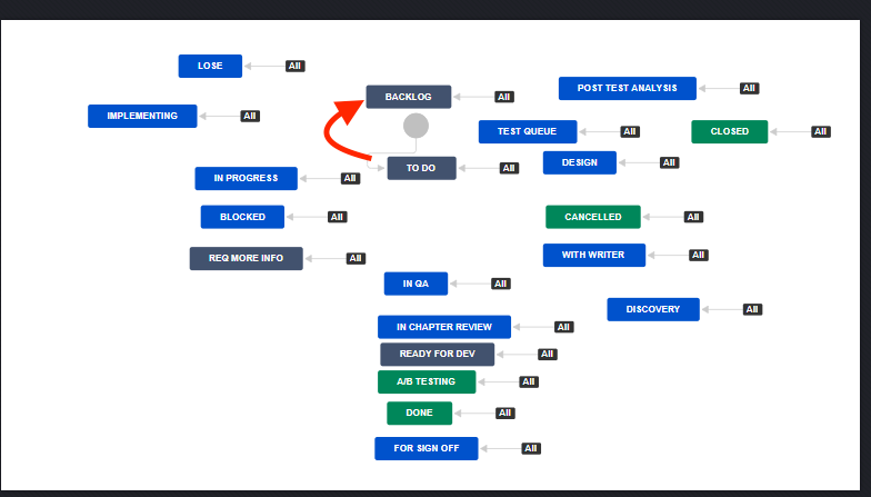

However, what I have noticed is that whenever I create a task, it simply goes into 'To Do' as opposed to Backlog, where we want to run check's to ensure it is actually ready to be worked on.
From this I figured I would need to ultimately update our Workflow so that it comes before To Do - am I right?
Here is a screen of our workflow:
https://gyazo.com/5d4e5b757f9634d8dc6d067fc74f6e2d
What I also figured was that to match my diagram above, I would have to alter our workflow accordingly, which would mean that it would change all the board's flow wouldn't it? As you can't have different workflows on the same Profect can you?

The simple answer is that when you create an issue it will automatically go to the Status from the workflow designated by the Create transition. That is the transition between the gray dot and a status. Looking at you diagram you would need to change the target of the Create transition from the To Do status to the Backlog status.
Workflows are applied to projects through Workflow Schemes. Through a Workflow Scheme you can have multiple workflows that apply to a single project, by configuring workflows to apply to specific issue types in the project. So, you can have multiple workflows on a single project, but not multiple workflows for a single type of issue in that project.
If you have multiple boards that reference the project, then changes to the workflow(s) for that project can affect all those boards. The affect on the boards depends on the change you make and how the board is configured. A board is just a way of visualizing and working with issues in 1..n projects.
